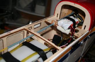

I chose to mount my Ignition battery on the throttle servo tray instead. There is a addendum on <a href=http://www.horizonhobby.com/Products/Support.aspx?ProdID=EVOE45GX2>Horizons website</a> about the newer ignition. It requires a 6 cell nicad pack or a 2 cell Lithium pack with no regulator. If the ignition pack voltage gets below 6.4 volts the engine will not start.
@20.jpg:Lithium Ignition battery up front.
@22.jpg:Main batteries installed and ready to fly!
