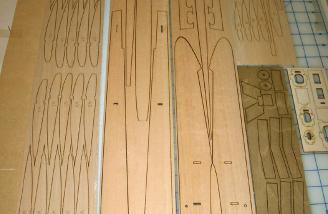

The 20” long box arrived in perfect condition, with rolled plans, balsa parts, quality hardware and an instruction manual. The small parts were sealed in plastic bags, sticks bound together (straight!), and the sheets of laser-cut wood packed neatly. Everything was included in the kit to complete the model except adhesives, covering, and electronics. The full-size plan sheet was drawn precisely and clearly reproduced. Isthmus Models knows their plans, and an experienced builder would likely have no problem building this plane from the plans alone. The plans did not include rib profiles, an omission that might make future repairs more difficult, but I traced the outlines from the punched-out laser sheets onto a white area of the plans – just in case.
I like to have instructions too, and was not let down with those included. The instructions were written clearly, with detailed construction pictures on the last two pages. I notified Isthmus of a few places where I felt the instructions were vague, and the enhancements have already been made. I would also prefer pictures and diagrams to be in-line with the text (like articles here!) and have made that recommendation.

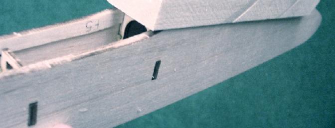

Fuselage Construction
The fuselage was laser-cut and rapidly assembled directly on the plans. I started with the bottom, gluing on 1/8” sq. balsa along each side of fuselage bottom, then I tacked on the solid balsa nose plug. I set that assembly aside, and built the two fuse sides. Each side had a back half and a front half. I butt glued the front side piece to the rear side piece, glued in ply reinforcements over the joints and ply reinforcements along the top for the wing saddle. I did the same for the opposite side. The fuselage top was tacked in place much later.
A builder can never be too careful when joining the fuselage sides together at the tail. Any alignment error at all will be difficult to correct and will adversely affect the model’s trim in almost all phases of flight. This was a good time for a break. After a day’s rest, I returned to the building table fresh and alert and successfully completed this critical step.
Fuselage shaping
The final shape.
Now the fun part, shaping and sanding! Before shaping, the assembled fuselage was blocky, the nose almost square, and the canopy just a balsa block. Mark’s instructions reassured me that carving this chunky thing into an aerodynamic shape would take only a few minutes and required but modest care and minimum technique. I tacked the canopy on with a few drops of medium CA and began shaping with a small plane. As the profile began to emerge, I switched to a medium grit sanding block to reveal the final shape. There’s plenty of balsa in the corners of the fuse, and the model benefited from aggressive sanding, especially in the tail. Finally, I finished off with a medium-fine grit sanding block lightly touching up and rounding all the corners. Then I used CA debonder to help break free the carved canopy cover. I hollowed out the inside of the canopy with a few strokes of a handy Dremel and a teardrop-shaped bit.
I was very satisfied with my fuselage!
