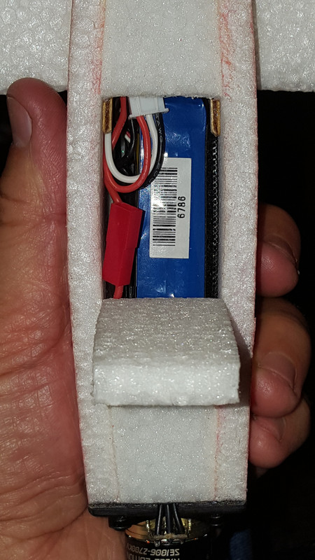

As you no doubt read further back it seems many had issues with it for whatever reasons and even mine snapped off the nose on a crappy landing. And it's a bit fiddly with the small fuselage. But if built light with a higher KV motor and smaller prop it really flies well. Will bank and yank on a dime.

I think I've broken more props with this thing than any other aircraft I fly. Broke the 6x4.5x3 on the first soft grass landing. Had pulled the battery and apparently got it too far forward on the reinstall. Landed to move it back. Replaced the prop with a speed electric 5.2x6 just for fun. Worked ok but would cavitate at low speed and high throttle. No surprise.
So on 2S with the 2700kv motor I'm sticking with something between 6x4 and 6x5.5, which is what was used for the maiden. And trying to hand catch. Some days I gots talent. Other days not so much.

The problem with reinforcing the fuselage is CG. Mine has the ESC stuffed as far back over the wing as it will fit, the micro FrSky RX under the wing as far back as it will go and the 2s 800mAh battery pushed back against the wing. With that and a couple of spars glued into the tail, it still balances right at the published CG. Any more weight forward and additional dead weight would be needed at the back. In hindsight it might help to notch out some of the wing inside the fuselage to free up a little more space.
DW Hobby's EPP is brittle, no doubt. I was thinking of some very small rod glued along the fuselage and had considered a folding prop as well. But since it does fly so well as is I think I'll leave well-enough alone and just try not to break it again.

2S 1000mAh batteries here so I guess I'll get to carve out some foam out of the wing
