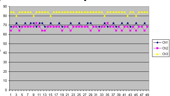

Here some graphics made with the serial-printed values :
Please add 1400 to have the real channel values
I don't understand why my values are moving like that !!

May 09, 2012, 09:25 AM

May 09, 2012, 11:48 AM
Hi,
Not really good reasons, they won't make anything faster or safer. As you mention you are a beginner I won't bore you with the reasons, other than to say I have considered most of the alternatives on the way to arriving at this code and as one of the comments from someone using my code states -
I really like your code and I think you did a great job and it works perfectly.
I can post an expanded version of the code which includes error handling I would suggest that you never 'forget' bad values in an autonomous project, you don't want to watch as 100's of dollars and hours of your project time smashes itself to pieces because you never told it not to.
If you keep the code as it is on my blog, you can replace the contents of loop from this comment onwards with whatever you need your project to do. If you don't want to use the flags you don't need to but dont take them out of the other parts of the code.

First, here is a new data analysis of my code (taken from DuaneB code without flag management) :
1400 have been stolen on each channel
The 4µs resolution is clearely visible.
This is really more precise than PulseIn AND this code lets the arduino works when there is no Rx events.
The only problem for me is the 4µs precision from the micros() command, this is making some kind of "leap year" problem.
