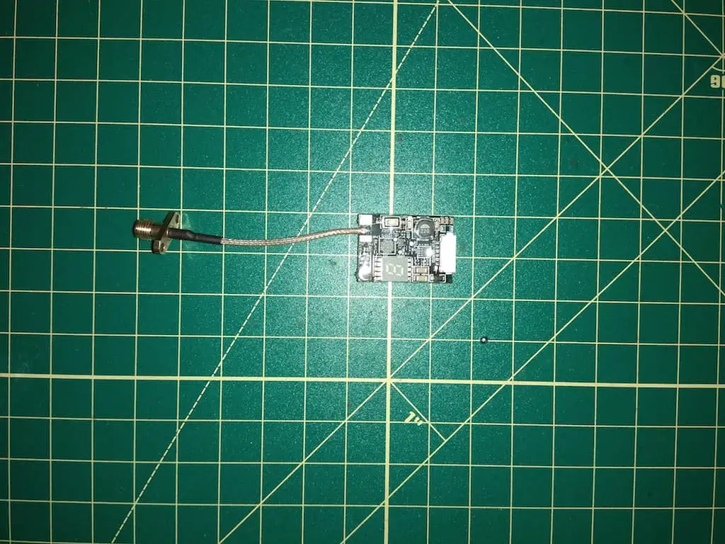

Posted by kryptonite1995 | Jan 23, 2018 @ 09:12 PM | 2,008 Views
Original link:https://www.propwashed.com/akk-x2p-v...mitter-review/
For almost a year now, the ImmersionRC Tramp HV has been our video transmitter of choice for use in miniquads. It has all the features you generally want—a pigtail for easy antenna placement, adjustable power levels and a great channel selection. I think its most important feature over VTXs of yesteryear is serial communication with the FC (generally called “smart audio”). This allows you to change your channel and VTX power through your OSD using your controller. No more fiddling with buttons, accidentally knocking fellow pilots out of the sky in the process. SmartAudio has become the hallmark of high-end VTXs. With the AKK X2P, that may be about to change—
AKK X2P Introduction
The bare AKK X2P weighed in at 8.2g
Chinese manufacturer AKK has a surprisingly robust lineup of quadcopter electronics—including flight controllers, FPV cameras, and of course 5.8GHz video receivers and transmitters. I was drawn to their site by the AKK X2P 5.8GHz video transmitter, which is a fully featured VTX:
$18.99 from AKK’s website (international) or $22.99 shipped from Amazon Prime
Supports all traditional FPV video bands including Race Band
Pigtail SMA female connector
Two other connector options available: board mount SMA and MMCX
Adjustable power output from 25mW to 800mW
7–24V power input support
SmartAudio support, allowing channel adjustment from OSD
Installation
I opted to replace my aging...Continue Reading
