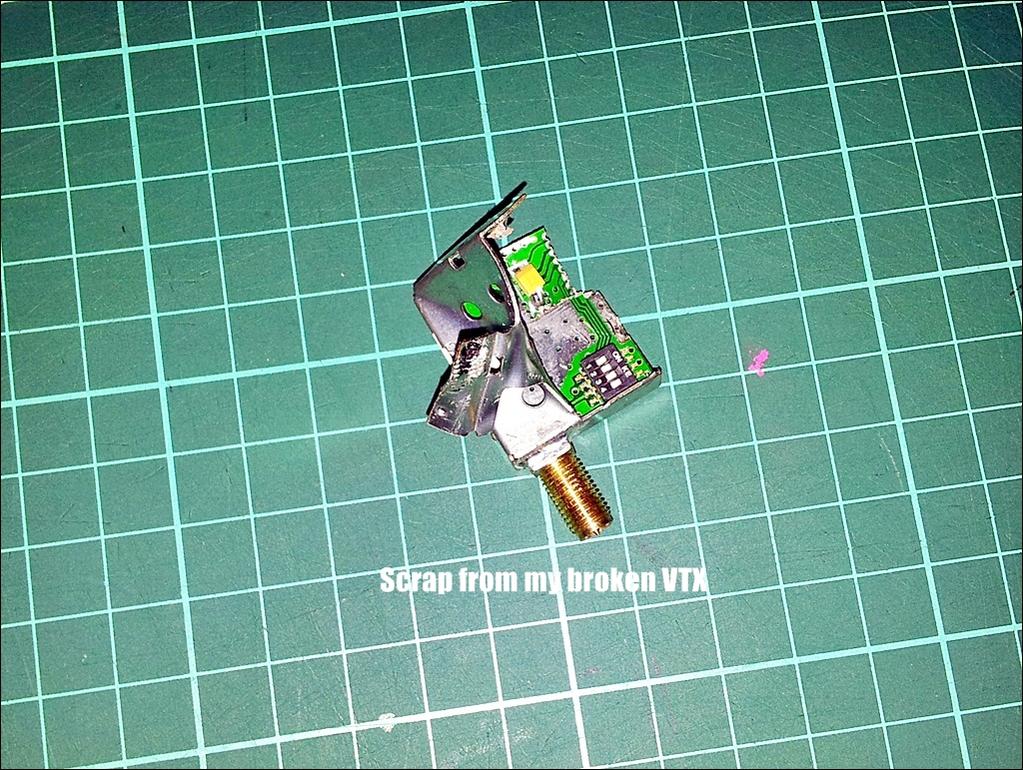

Part list
- Header pin (need 9 pin)
- Perf board or some shop call this donut board
- PCB Mount SMA male for the VRX note most 5.8ghz use RP-SMA making it to use SMA mean you have to make your own antenna or use a converter
- VRX of course ebay sell the in pair which is recomended! as $22 for a pair!, but Foxtech sell the VRX for $15
http://www.ebay.com/itm/251063978745...84.m1497.l2649
http://www.foxtechfpv.com/rx5808-58g...ule-p-303.html
I have not tested it yet as my VTX is broken once I get a new VTX or soldered the bare VTX modules I post the result,
Now maybe picture of the build log will give some interest
the parts
no pcb mount yet so i use the one from my broken VTX
