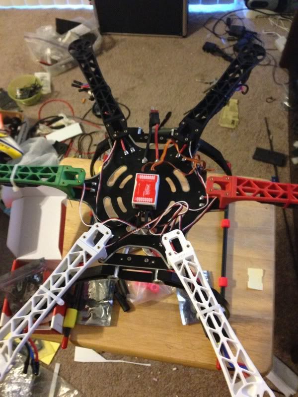

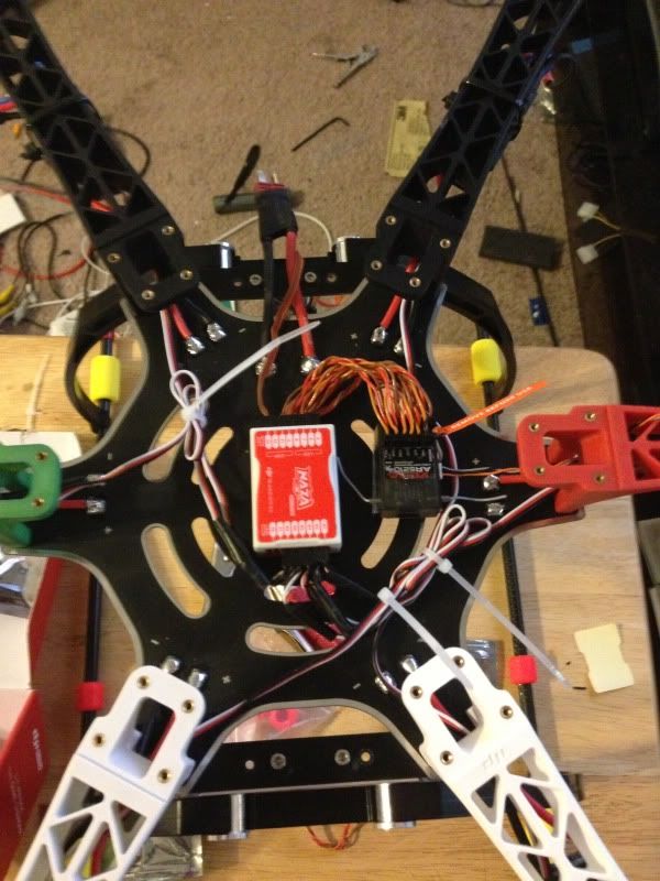

A few pictures of my resurrected f550 clone. White for front, green right and red left. You get the point.
Had used an ar6110 dsmx, changed it to an ar7010 for all functions.
All zip tied and ready for top plate. Also mounted VU on underside for visibility of LEDs.

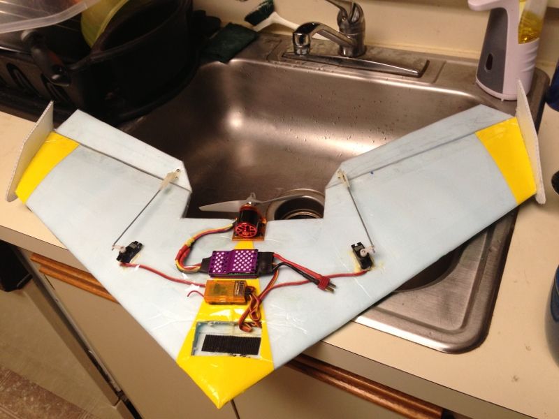

Posted by postalflyer72 | May 01, 2013 @ 09:31 AM | 3,985 Views

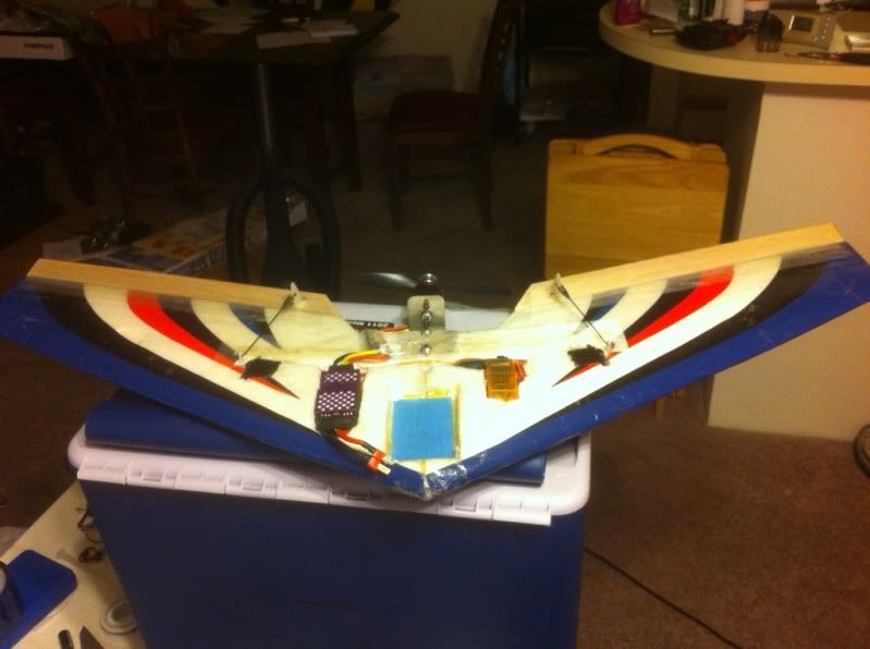

i decided to make this beauty an fpv wing. seen another modded and decided to go for it. basic assembly with epoxy and some gorilla glue. setup is corona mg939 servos (awesome ones too), D2826/6 2200kv motor on a 6x4 prop, mystery 40a esc and dsmx receiver. fatshark 200mw 5.8ghz transmitter with a 520 micro camera from readymaderc.
magnet on lid and wing. dont want to see the canopy fly with my gear. the rod is just to hold the magnet down while it cures.
installed the verticals but first painted the yellow.

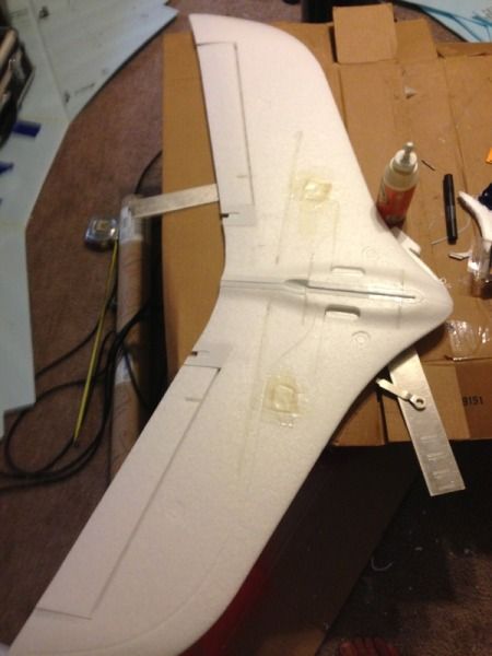

Posted by postalflyer72 | Apr 09, 2013 @ 07:58 PM | 4,451 Views

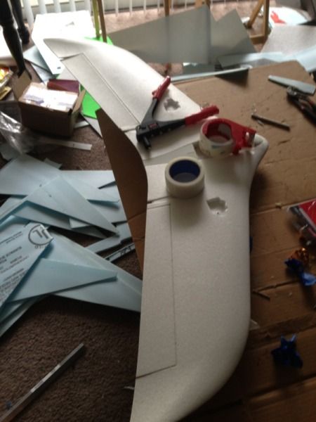

I recently purchased a xeno for only 20.00. beautiful wing but many issues i didnt like about it. power system with shaft is expensive and not practical, servos are bottom mounted, which i dont like at all, folding of wing presents some structural issues and last during low speeds seems like verticals are not long enough.
first mod, gorilla glue the center and say bye bye to folding wing. its small enough to fit in any car.
second mod, not only move servos to top but also line them up with fold of elevon. common Multiplex! a simple thing to do, perfect alignment of servo to elevon to minimize binding.
third mod, remove carbon fiber piece and insert a cf arrow full lenght. just eat some of the center plastic and voila! strong wing.

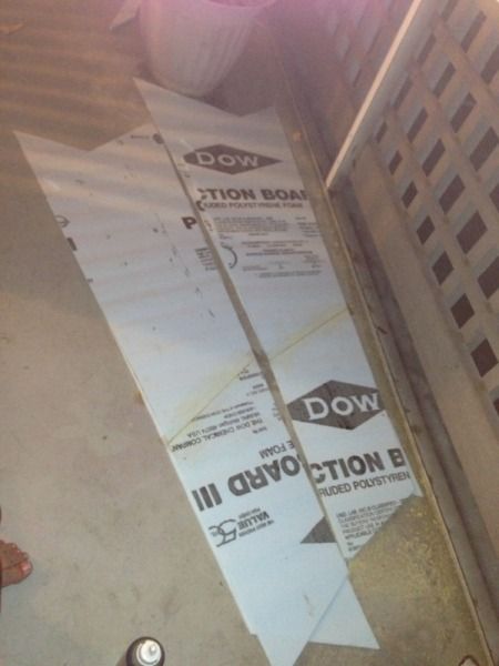

Posted by postalflyer72 | Mar 23, 2013 @ 01:25 PM | 7,363 Views

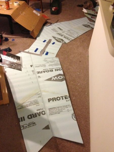

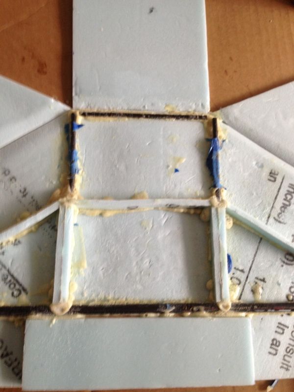

last wing i made was 150". i tried too many things on such a large wing. main or coolest part was detachable sections with cf arrows holding it. not only did that create a heavy section but the flex was still there. recently i have been building blunt nose wings. main reason is damage to the nose is minimal and a stronger section. here is my latest while trying to keep the K.I.S.S. method of building. its a simple aluminum frame, 1/8" plywood battery tray and motor plate. i might add some cf arrows for flex with the addition of foam pieces parallel with the metal. this is so the frame doesn't cut into the blue foam and make it wider. some pictures of my progress.

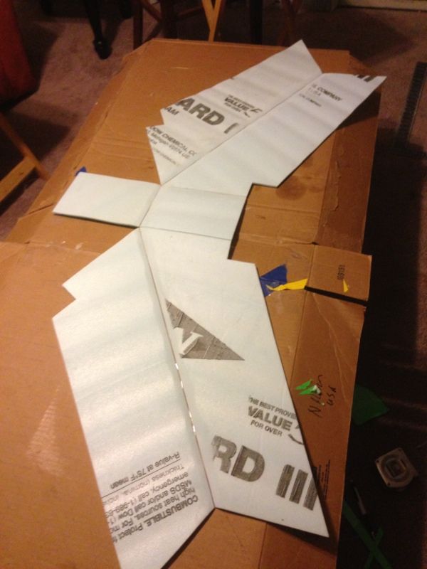

Posted by postalflyer72 | Feb 26, 2013 @ 06:01 PM | 3,522 Views
a lesson learned again. dont decorate the crap out of your new wing until maiden. i made some serious mistakes on this one. first was tip chord was too long. it wouldnt even balance on a 2200mah. some pictures of the build. by the way template number 2 has been cut and all mistakes corrected, i hope. pics of V1. to add more pain. i made 3 of them without testing one first. big ouch!!

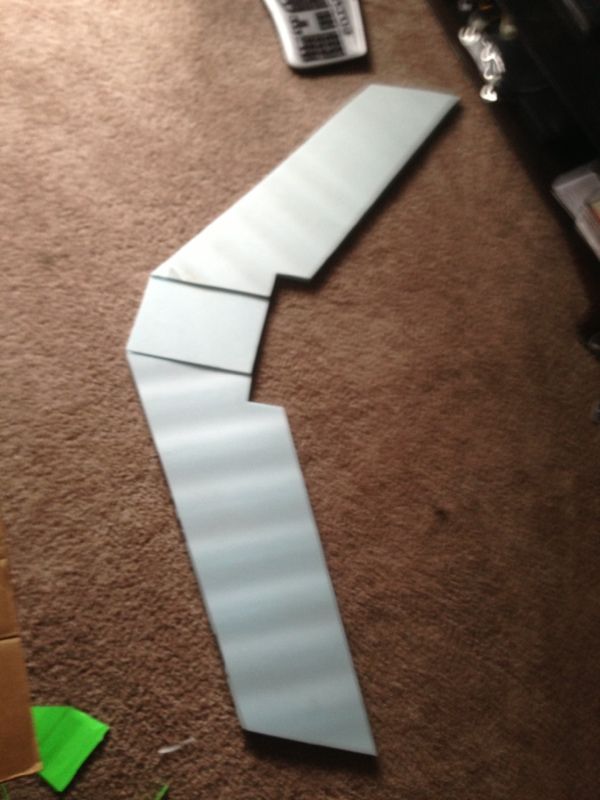

Posted by postalflyer72 | Feb 26, 2013 @ 08:57 AM | 3,411 Views
So i decided to build a blunt nose. why you ask? tired of doing some damage to the pointy nose of wings. also wanted something cooler and new. so i made a template for a 46" with the mistake of not taking into account that all the things in the middle folded, would add more area to the top. i basically cut all pieces the same length. so at gluing time i ended up with lots of dihedral. this wing was for practice fpv with 2 1300mah 3s and cameras in the middle. the 900mhz system was so dirty that it would brown out my receiver at 2.4ghz. the flight was wobbly and had all kinds of issues. i came home disappointed. then i decided to close all areas of the lipo and place a single 2200mah. keep it light and simple. this wing is now one of my favorites. flight time is at 15min with about 30% left. a park 480 1000kv on 9x6 pushes it. this is a short one at 35mm wide by 30mm long.
pretty template.
learned lesson. top center piece should be last after all glued.

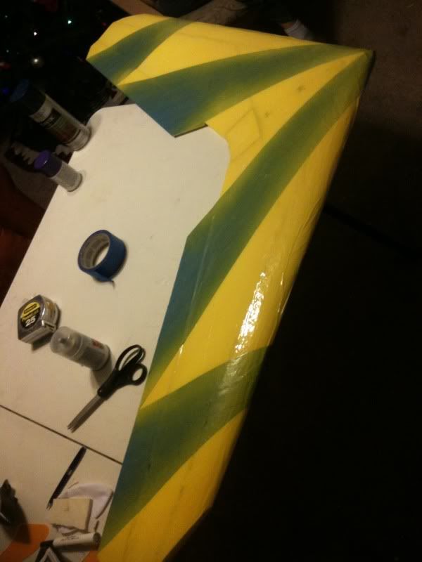

Posted by postalflyer72 | Apr 07, 2011 @ 06:04 PM | 6,680 Views
It's been long overdue that I do a blog on my reaper. It has taken lots of work to get it flying like it is. This is intended to also help others with more economical ways of building the same thing based on my experiences. Here are some earlier pictures of my wing. The plastic board fins lasted 2 flights and are junk. They have a nice neon but are useless.
Painting was easy but the paint is not durable and I worry that laminate won't hold over paint if I choose that.
