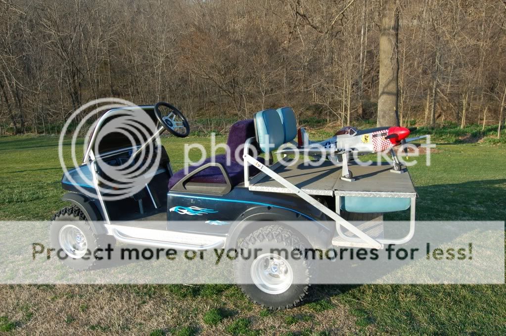

My Big P-51 Transporter! / "Auntie Samantha"! / & Decals!
This is my "BIG P-51" transporter! I don't have far to drive to get to the fairway, errrr...runway of my choice. Actually, I build these custom Club Cars as a side line.
This is my 35mph "Cruiser"!
