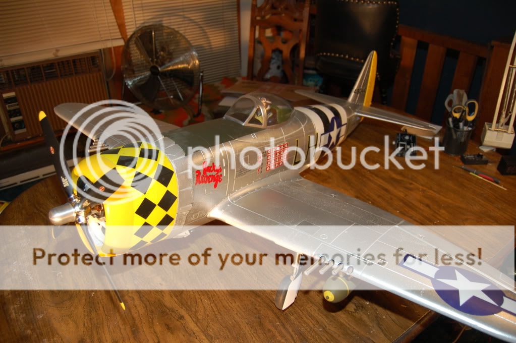

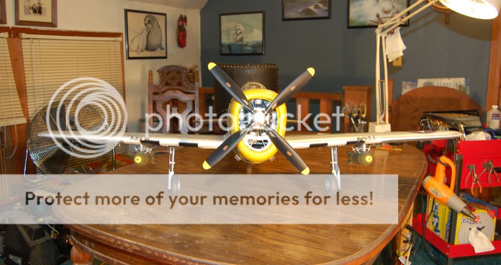

This is my Build Log of the.... FMS 57" P-47 Thunderbolt "Jacky's Revenge"!
Motor.....
ESC.......
BEC.......Castle Creations 10A
Lipo.......
Servos:
Ailerons....HXT900 9g
Flaps........HXT900 9g
Elevator....HiTec HS-82MG
Rudder.....Hextronic MG-14
E-Tracts.....PZ15091/514
Struts.......40-120 Aluminum oleo P-51
Tail Wheel..Handmade
Recommended CG is 80-85mm from LE.
Following throws are from a fellow forum member:
Ailerons: 1/2" each way
Elevator: 3/4" each way low rate __1 1/2" each way high rate only for taxi to keep the tail planted.
Rudder: As much as you can get
Flaps: As much as you can get

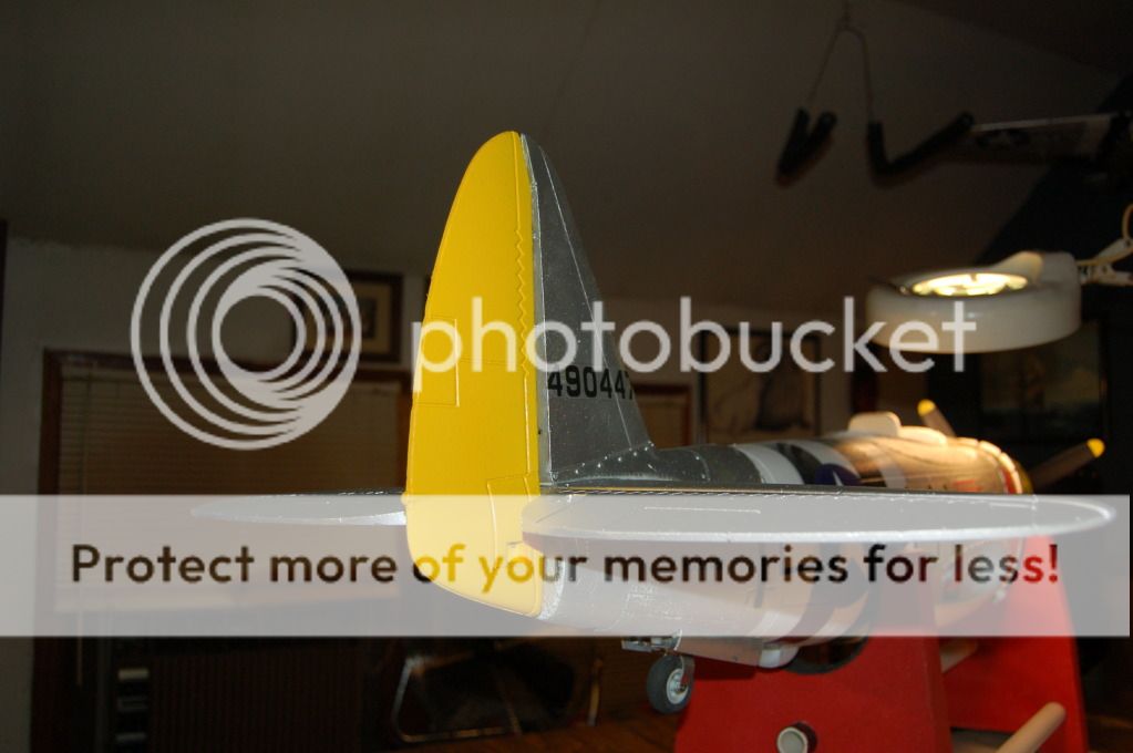

UP-DATE 2/13/2011: Got back on the JUG this past week, and got some work done on the 'ole girl's Tail Feathers!
I cut the control surfaces in preparation of re-hinging both the elevator and rudder. But first I needed to install a spar so I routered a groove to install the .220 x .092 flat CF. I glued the spar in with GG, and once cured, I filled with Squadron putty and sanded smooth.
Once the spar was done I started on the hinging. I used some pivot point hinges on the rudder, and some of these Super Lite hinges from HK. This is the first time I have used these, but I must say I do like their concept. They slip in just like a regular pinned or CA hinge. They have a dam which keeps the CA from getting on the pivot section, and were easy to install.
After getting the hinging done, I set out to install the .092 joiner rod on the two control surfaces to eliminate the dual push rod set-up....Continue Reading

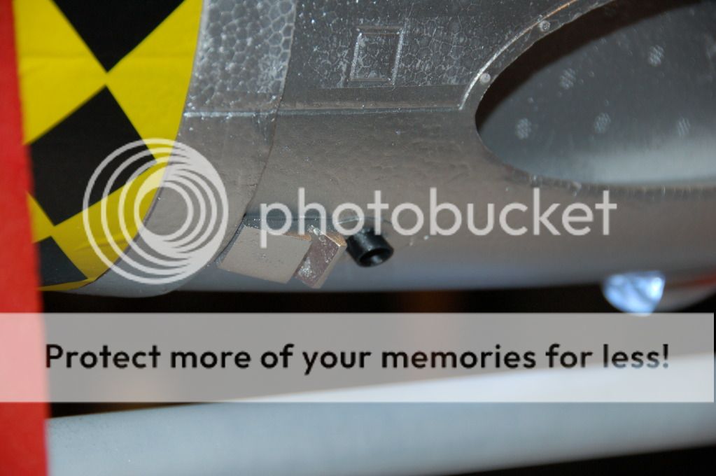

I have to admit this mod took me some time to complete, as I debated back and forth how I was going to do it?
Because I am using the FMS/PZ E-Tracts for the mains, I wanted to use the same unit for the tail wheel. What I opted for was the HK/PZ E-Tract with the smaller base plate because first, I was going to be making my own mounts, & second, it's much easier to turn a 4mm round leg then shape a 5mm square leg.
Because of the room this assembly needs for clearance I decided to go against scale and have the tail wheel retract forward. Once I started cutting foam, everything I was trying to accomplish became much easier.
One thing I thought I would have to sacrifice was the forward vert. stab. mount? For now I was wanting to keep the option of removing the vert. stab./elevator assembly in case the need arose. I was able to come up with an idea to achieve this by simple cutting the forward mount off and devising a my own with a 3mm T-nut and a brace glued to an upper ridge.
Of course I was going to make some bay doors! I used the same technique for these as I did on the Mustang....Continue Reading
