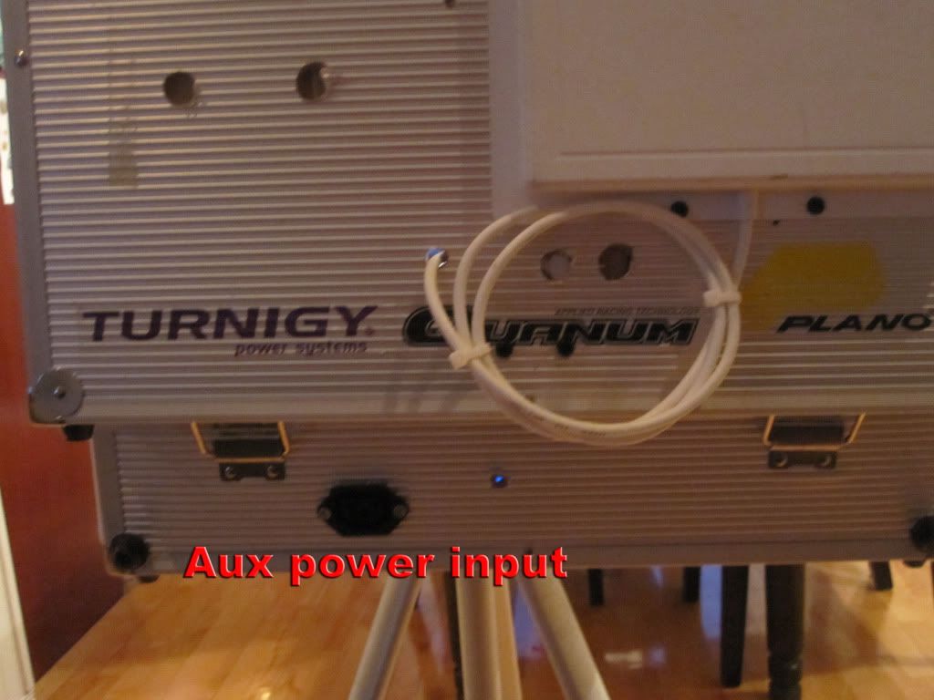

Let me share my ground station V2 ;
After getting 2.4 for video on my planes i needed 1.2 for my quad because i am flying on 2.4, so i had to make it all together.
  • Home depot case with recycled laser level tripod
  • 5A 12volt sealed pb batt
  • EagleEye diversity
  • 2x 1.2ghz video rx
  • 2x 2.4ghz video rx
  • 1 patch and 1 omni for each frequency
  • frequency select switch
  • vupoint recorder
  • 5.8ghz 20mw vtx to send image to fatshark's
  • external audio/video jacks
  • 7" liliput lcd monitor recycled from old CarPc project
  • switch to select onboard power or outboard using the back plug and extension cable with cig plug
Let the pictures talk for themself ;
