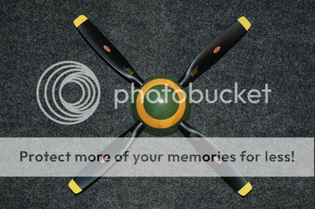

I stripped down the prop paddles and got them a bit more scale....... In fact their a whole bunch more scale then before!
Like I mentioned before, Starmax list this prop at 16"X6X4, but by all my measurin' sticks I get 15"X6X4!
I've included a PDF file for D/L for those who would like to make their own Hamilton Standard & Spec. decals.

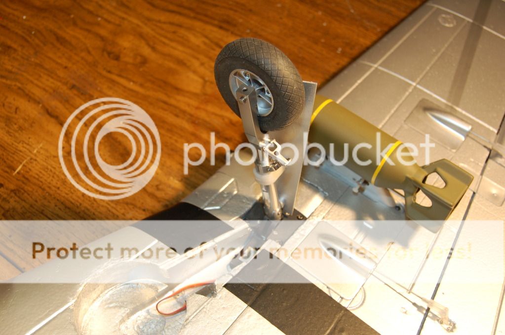

First on my list was the Landing Gear. After much deliberation I've decided to stick with the stock location, even though it's not scale! The E-Tract socket isn't as far back from the LE as I was afraid it was going to be.
I can see why so many guys are having issues with the E-Tracts! These ChangSuns may be fine for a Parkflyer, or maybe an EDF, but they are in no way suitable for a plane of this size! Come on Starmax, what were you thinking? It was a no-brainer, the PZ 514s were going in!
I have also decided to go a different direction on the struts as well. I have had a set of 120 Class Offset Oleo Struts from RCSkyLite for some time now, and after comparing them with the stock struts, I found them to be quite suitable for a replacement. Both the diameter and lengths were right in range with each other, so with the advantage of the RCSkyLites being aluminum and oleo, I decided to use them instead of the VQ's.
To get them to fit, first I had to disassemble them so I could chuck the upper shaft in the lathe so I could center drill the 5mm hole for the leg. I then cut 1/2" off the top at about a 70 angle so the strut would conform to the inclination of the wheel well. With the upper shaft disassembled I drilled and tapped a 4-40 thread hole for the set-screw to lock on the leg. I also made up a lower skirt bracket out of nylon and slid it on before...Continue Reading

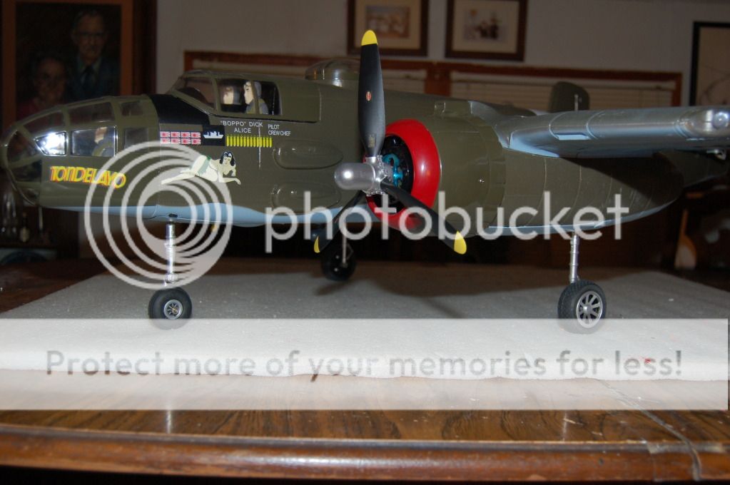

This is my build of the....FMS 1470mm Mitchell B-25 TONDELAYO!
