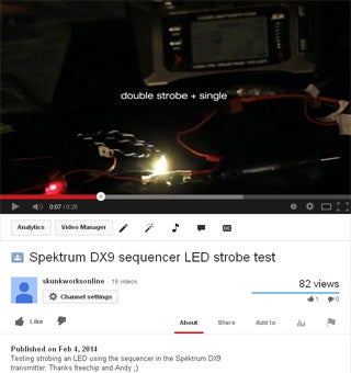

Posted by North_of_49 | Feb 23, 2014 @ 04:08 PM | 37,928 Views
I was asked to do a blog post about this...
click image to watch at YouTube

Setting up the sequencer to strobe an LED
I was able to figure this out with help from RCG members freechip and Andy Kunz (Andy posted a sample strobing sequencer file in the DX9 thread for me to analize and play with... mine is a...Continue Reading
