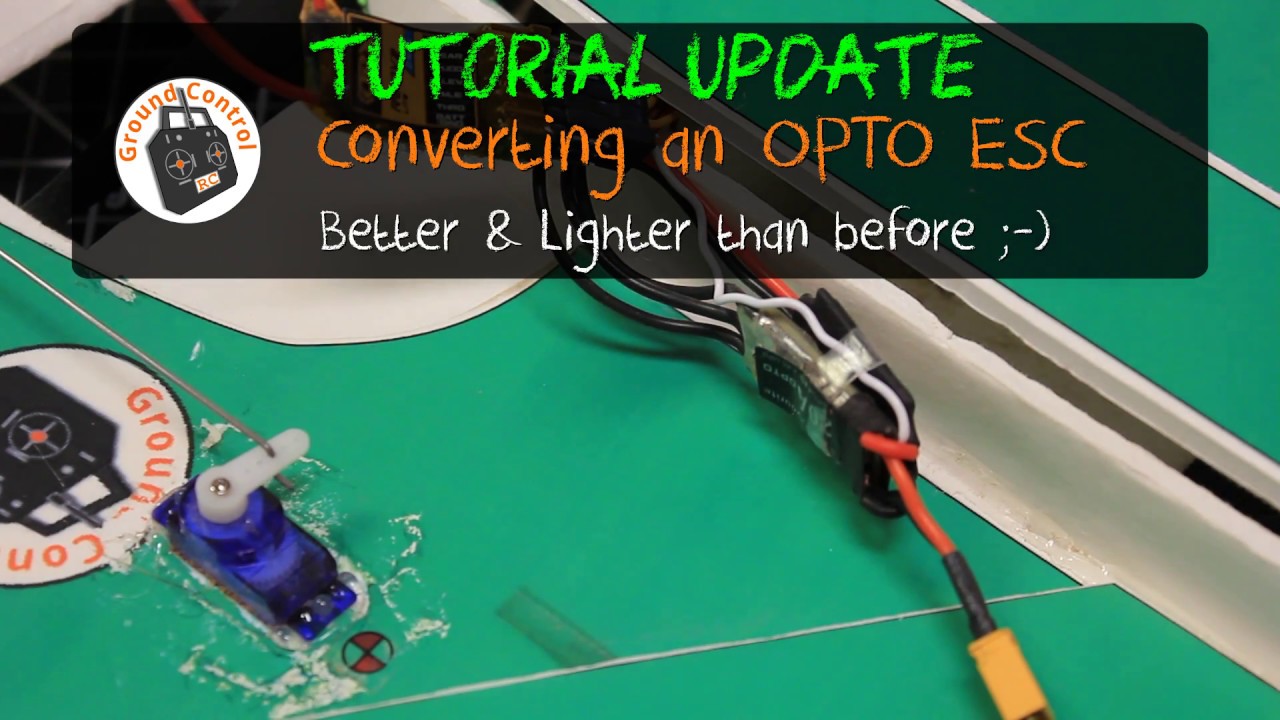

Tutorial Update - Converting an OPTO ESC by adding an SBEC
The Video is posted Here:
Tutorial Update!!!!
A post by "Per Buch" on this video brought to my attention and corrected my Brain-Cramp in that you do not need two servo connectors on this setup.
You can clip the Ground Wire on the ESC and move the ESC Signal Wire to the Voltage Regulator Power and Ground Servo Connector and it will work fine.
I tested this setup in my Parkjet over the course of 40 flights and it worked great!
Now there is no downside to using this setup as it only requires 1 Receiver Port ;-)
It also decrease the weight to 10.9 grams ;-)
Even better!

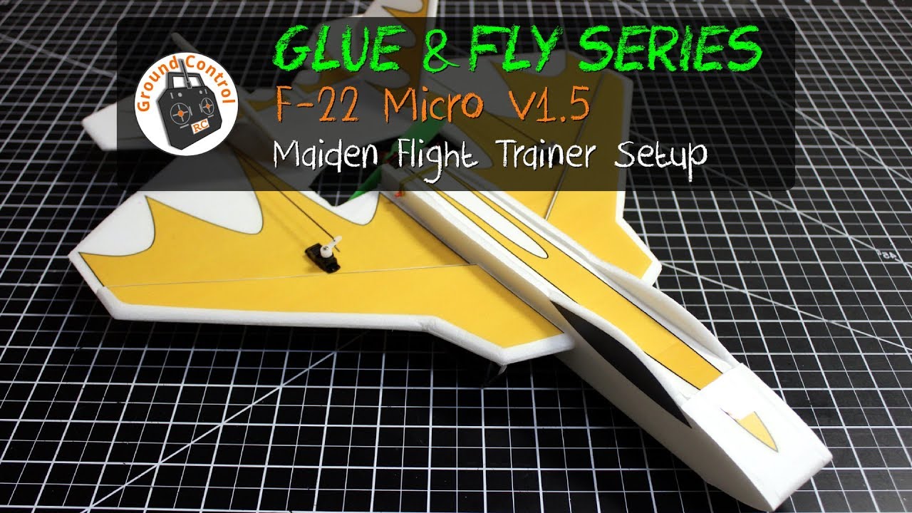

Glue & Fly Series - Maiden Flight of our Latest F-22 Micro V1.5 Airframe
Here is a link to the Video:
https://www.youtube.com/watch?v=mUe-QzTBiRg
I'm always a bit nervous performing Maiden Flights via Line-Of-Sight.
My Line-Of-Sight skills have greatly improved over the past 3-4 months but I still have a long way to go.
The All-Up-Weight of this Micro Parkjet is 119 grams with a 2S 450mah 65C LIPO.
The Thrust-To-Weight Ratio with this 2S LIPO is 1.3:1
This is our trainer setup for this Micro Parkjet.
For an Intermediate to Advanced setup all you have to do is replace the 2S LIPO with a 3S LIPO ;-)
The 3S LIPO we will be using is a 450mah 65C LIPO as well.
I will post additional flights of this Micro Parkjet in Trainer Setup and then it will be time to perform the Re-Maiden with a 3S LIPO in the Intermediate and Advanced setup ;-)
My observations on the Maiden Flight:
* The Parkjet was slightly tail heavy
* The fact that the plane was a bit tail heavy made the controls a bit twitchy
* After the 4 minute flight the LIPO Cells were at 3.7v per Cell
* Estimated flight time with this setup should be approx. 6 minutes if your in the throttle a lot like me ;-)
* With a Micro FPV System operating at 25mw it will probably be around 5 minute flights ;-)
I'm pretty darn happy with the way this Micro Parkjet flew on the Maiden Flight!
If someone with my Line-Of-Sight skills can fly this Micro Parkjet on it's Maiden Flight and also perform basic Acrobatics with it and not have any problems, then a seasoned Pilot will certainly not have any problems ;-)
