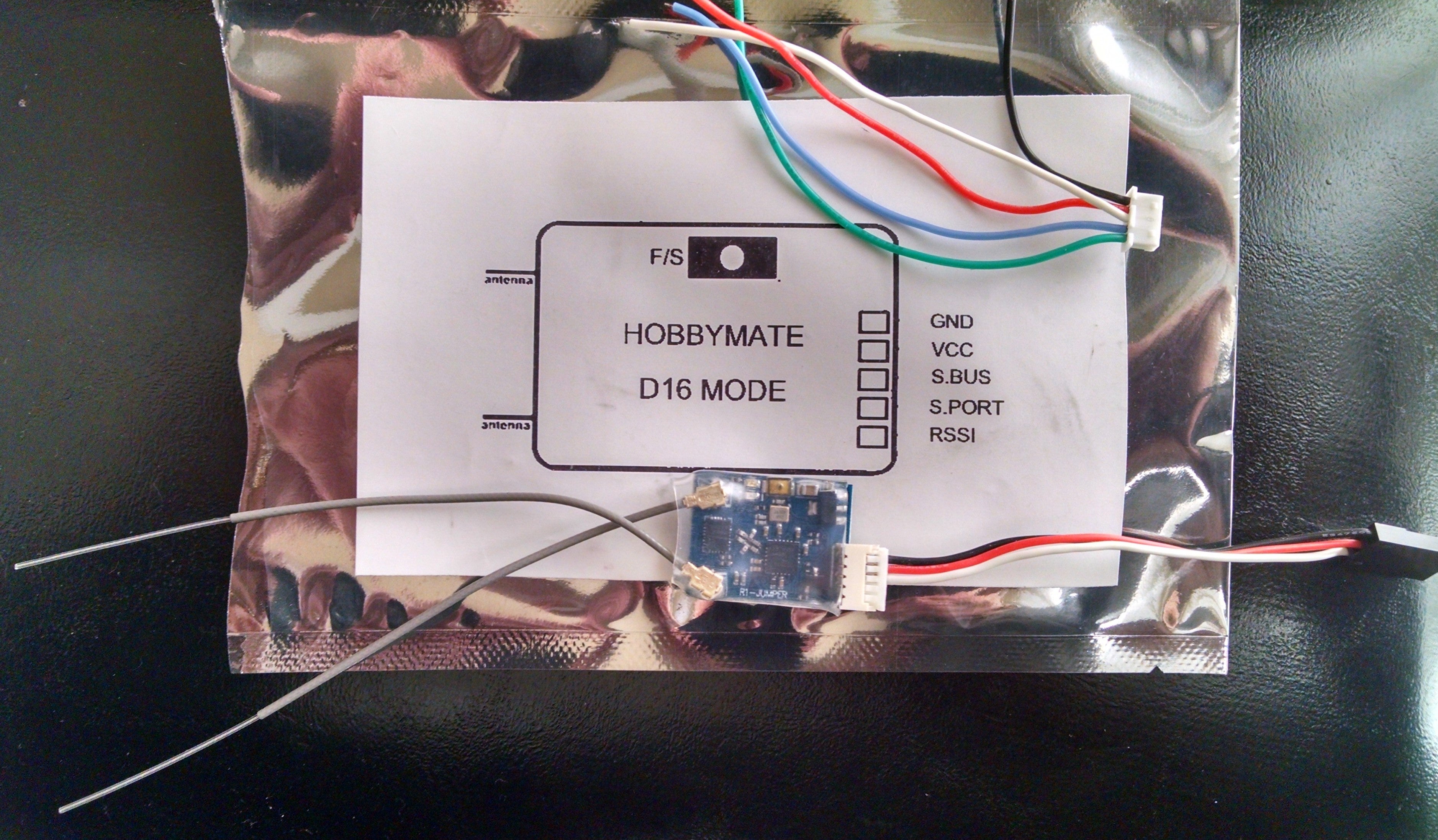

Documenting and testing the Hobbymate FrSky compatible RX.
I've had very good experiences with other Hobbymate products, starting with some 2204 motors that I bought a few years ago and continue to use frequently.
Below is all that came with this RX purchase:
As you can see above, this came with 2 output plugs ... one that can be used for simple SBus output to something like a simple gyro like the A3Super2 I will first use for range testing AND another that will allow me to wire it to a quad's flight controller.

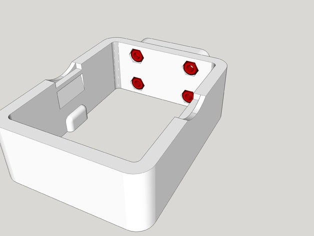

My son has finally gotten a little interested in RC. I was planning to give him my DX6i but realized that my old Flysky T6 has a few more programming features and would be a better platform if only we could add modules to it.
Since he has a 3D printer I got him to print a case with a module bay/box that can be attached to the transmitter carry handle.
Next I found a diagram for the trainer output showing me that I should be able to get PPM off the back of the T6 transmitter.
My son had an old S-VHS cord to use for plugging into the trainer port.
The module needs 3 of its 5 pins to be connected to operate:
- PPM signal coming from the back of the TX
- Power or V+
- Ground
