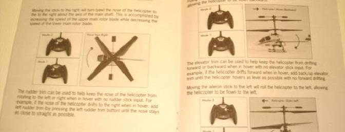

With the RTF version of the Blade mCX ultra-micro helicopter I received a Mode II transmitter. The left stick controls throttle: up and down, as well as rotation in either direction. The right stick controls direction: forward and backward as well as to either side. There are digital trim buttons for these controls to allow for adjustment so that the helicopter is as stable as possible with the control sticks in the neutral position. That would at first blush appear to be all the control available from the standard transmitter with the RTF model.
However, having read the instruction manual as my battery charged for the first time I learned on page 22 that the MLP4DSM transmitter comes equipped with a Dual Rate feature! This feature allowed me to toggle between the high and low control rates for the aileron, elevator, rudder channel and even the throttle. These are either all on low rates or high rates. To toggle between the two I just pushed down on the right stick on the transmitter, with the transmitter turned on and heard an audible click.
When first turned on the transmitter was on high rate, and the red LED on the transmitter glowed a solid red. High rate gave me the most movement of the servos and therefore the most movement of the helicopter. I clicked down on the right stick and the red LED on the transmitter flashed to show that the low rates were now on. Low rate was recommended for the first time or less experienced pilot as the reduced movement makes the available control smoother for more easily controlled hovering and flying.
The primary flight controls were very well explained so that anyone who takes the time to read about them in the manual should get a good basic understanding of how to control the Blade mCX.
