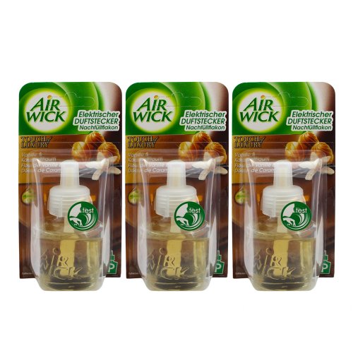

Originally Posted by Darksmile View Post
The name of the plane "Polar - CAT" was the reason to search for a good looking Pilot.
So i found one :-) That "gothic looking" kitty with the black skull bow tie.
Excellent-excellent on all counts.
Is that windshield from scratch? Or did you cut it out of a bottle or something else?
The curves look too complex to be scratch, but the shape doesn't remind me of anything it could have been made from.
jbarchuk is offline Find More Posts by jbarchuk
Old Feb 18, 2013, 03:05 PM
Darksmile is offline
Find More Posts by Darksmile
Joined Jul 2011
29 Posts
That windshield is packing of a "scented plugin" called "Airwick" in Germany.
Bought one and in the moment i wanted to throw it to trashcan i got that intension, this would be a wonderful windshield for the "Polar-Cat"
http://ecx.images-amazon.com/images/I/51mq0mjCoUL.jpg
Walking through stores an look here and there and i sometimes find things to misuse
So i found a nice looking canopy for my Blade mQX
