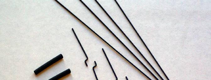

Push rods

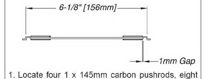

The Pluma stays light by utilizing a lot of carbon for push rods, bracing and the aileron connections. Though you may be used to being able to make adjustments to the push rods at any time after the build is complete, the Pluma push rods are a little different: You are required to make them up yourself as a part of the build, and once you have made them, they are fixed and nonadjustable. Great Planes includes some control surface alignment tools which help ensure that you get the dimensions of the push rods and the control surface neutrals perfectly square. BE CAREFUL when inserting the z-bends though the horns or links for the first time. Work them through slowly. If you try to force them through too fast, you may break the horn or link. I had spares in my kit, fortunately.
The manual suggests building the push rods on the bench and then installing them. Even after the heat tubing has been shrunk, you can still slide the z-bend around enough to make some final adjustments. Doing this after they are installed on the plane will guarantee perfect alignment. I would strongly discourage trying to shrink the tubing while the push rods are mounted on the plane. Foam and heat do not get along, and you will scorch the Pluma. Also, take care to use the CA sparingly. Do NOT let it run through the tubing and find its way to where the z-bend goes through the horn.

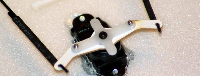

The Futaba 3114 servos provided for this review came with the lightweight micro connectors instead of the standard size connectors. These servos fit perfectly into the servo recesses on the fuselage and wing. I always prefer hot glue for mounting the servos. The receiver slips into the large hole to the front and bottom of the fuselage. Great Planes includes enough hook and loop fastener material to attach the receiver, lipoly battery and speed controller in this compartment. The hook and loop makes it easy to swap out one power system for another. There is enough room in this compartment to shift these components around, which assists in finding the correct center of gravity.
The assembly manual recommends using the large X shaped servo horns that come with the 3114s. The aileron servo benefits from a special, larger horn that comes in the Pluma kit and mounts to a regular Futaba servo horn. This setup facilitates some pretty extreme throws on the ailerons and at the same time adds in some mechanical aileron differential. This shows some definite forethought on the part of the design team. They apparently determined the Pluma flies better with such differential, and creating it mechanically saves each end user from having to experiment with radio settings to get it right... provided their transmitter even has such a feature!

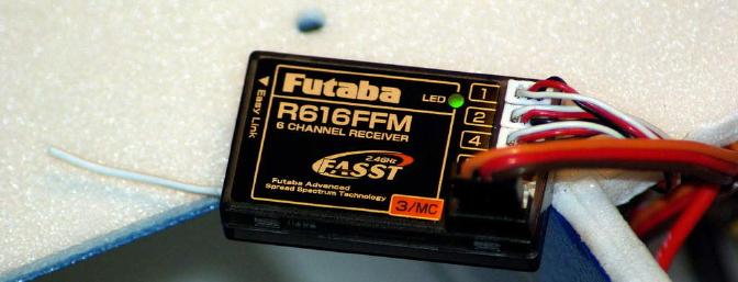

The Futaba R616FFM 2.4Ghz receiver has a very small footprint due in part to its use of the micro JST style of connector on all channels except for throttle. The throttle channel uses a conventional style and size of servo connector.
One small caution: When trying to fish the servo leads forward to the radio compartment, DO NOT hold the plane up over your head to allow the overhead lights to illuminate the inside of the fuselage when the ceiling fan is turning! You'll notice in the photos that my rudder looks as if a great white shark took a little nibble out of the trailing edge. Yikes!

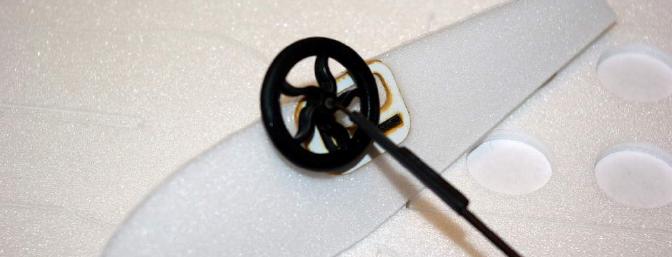

The landing gear comes out of the box assembled. The small plastic wheels are already mounted to an axle and wheel pant, which extends out into a long carbon rod. These pass through the lower wing, and then into and through the fuselage. This serves to spread the load of the landings across several pieces of the airframe. Even so, the manual advises against landing on all but the smoothest surfaces.
You may be wondering what you are supposed to do with all of the carbon rods you still have lying there in a pile? The Pluma airframe utilizes quite a few carbon struts and braces which really stiffen the airframe up nicely. When installing and gluing them however, make sure you use a perfectly flat building surface. A little extra attention here will go a long way towards ending up with a very straight and true plane.

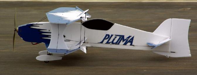

With the outdoor power system installed, my All-Up-Weight came in at 10.4 ounces.
I was sent two different power systems for this review: One is designed to keep the Pluma as light as possible for flying indoors, the other is a slightly heavier outdoor setup. I first flew the Pluma on the more powerful outdoor setup, and on calmer days, this combination makes for great fun! I have even had the Pluma out on days where the winds were 5-10 MPH, and it is still entirely manageable in my opinion. (There was one instance where I flew it just a little too long and was unable to make it back to the runway when the power sagged due to the battery hitting its low voltage cutoff threshold.) A half a pound worth of plane will get pushed downwind and it will not take too much wind to do it, but the outdoor power system has plenty of oomph to overcome it and also climb straight up vertically and then some.
I installed the indoor power system with the hopes of flying indoors at a recently discovered nearby indoor flying venue. But I first took it down to the local park and gave it a whirl. I immediately noticed a change in its flight characteristics. The loss of weight achieved by going with a smaller motor, speed controller and lipoly battery is readily apparent. The Pluma will still go vertical but it takes almost full throttle to do it. And any wind at all will have its way with the Pluma, requiring you to manage the throttle even more aggressively. I was eagerly looking forward to flying it indoors to see how the indoor power system performed in its intended environment. To my dismay, the regular crowd of attendees were visibly perturbed when the Pluma rolled out onto the gymnasium floor. They shook their heads in an obvious sign of disapproval, telling me they thought the Pluma was too large for the gym and that it would disrupt the flight of their free flight models with the prop wash from it's massive 8 inch prop! Not being one to rock the boat, I decided this visiting newbie should not upset the old timers if at all possible.
I am still on the search for another venue to have some indoor fun with the Pluma. I was a little let down that I could not file a report on how it behaves in the "perfect air" that an indoor venue provides.
As the first flight reports of the Pluma started rolling in, I noticed several folks complaining about perceived weaknesses in the Pluma's landing gear. But it appears that it was not designed to handle a rough runway surface; And no wonder: it was designed as a super lightweight aerobatic and 3D plane. Adding a lot of extra weight and mass in the way of more robust landing gear would probably somewhat sacrifice the excellent flight performance.
Takeoffs and landings are not difficult at all. A deft touch on the controls will assuredly prevent any damage to the landing gear but set her down hard or try to roll out on a bumpy surface and you will probably jar the gear loose or break a wheel pant. Although my first outdoor landing snapped a wheel pant, paying closer attention to throttle and flare on subsequent landings prevented any repeats. Minimize the length of the roll out on both take off and landing and the actual impact of the touch down and you will minimize, if not eliminate, the need to keep the CA handy. I decided it best to hand launch the Pluma when flying it outdoors, unless a very smooth runway is available.
The hand launches are a piece of cake! Hook a pair of fingers under the leading edge of the top wing, aim the nose up at about a 45 degree angle, power up and let her go!
