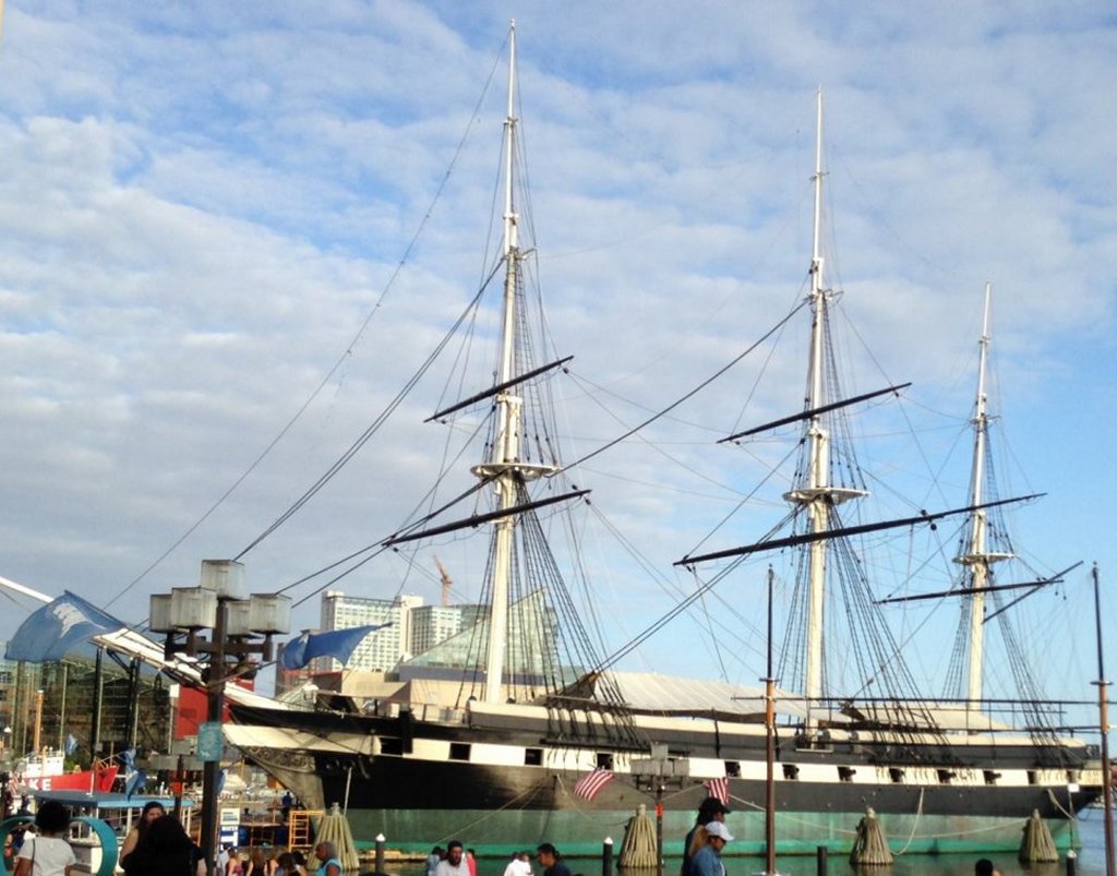

The Constellation:
I've lived in Baltimore a long time and I'm very familiar with the Constellation and have even been involved with her controversy. Mine was among the voices that said "Finally!" when it was announced she would be restored as what she was; a 22 gun sloop-of-war built at Gospost Va in 1854 and the last all-sail warship built for the U.S. Navy.
So here she is today:
A few years back, someone at the Naval Academy dug out of storage an old half model that turned out to be the builder's half-model of the Corvette Constellation. I saw it then and thought "that is a nice size for a working model - and the research began. The National Archives have drawings to match the 1/36th scale half-model along with all sorts of material on the ship from various stages of her history. I decided I wanted to model her as she probably appeared in 1861 when she captured the first Confederate flagged vessel.
On the model side, the book Building a Working Model Warship: Hms Warrior 1860 by William Mowll was inspirational - specifically in construction method. I decided to make a mold and turn out, at least, 3 fiberglass hulls: One would be my sailing model, one would be finished with stump masts as a display model and sold to pay for everything, and the third finished the same and donated to the real ship.
So, a sacrificial plug was made, and is, so far, unfinished. It is made of plywood formers with scrap pine strip stringers and is covered in brown wet-n-stick packing tape, just as Mr Mowll did for his Warrior model. The tape shrinks as it dries tightening like a drum-head. Sitting for years now, it's still tight.
This (long winded) post is the first in what I hope will be a chronicle of a revived project to build a working model of an important vessel in Maritime and Naval history.

Don't forget that this is the second USS Constellation, not the 36-gun frigate that was built with the other five original frigates.

Baltimore acquired the ship around 1955 when Boston was going to scrap her. Incorrectly listed as the "frigate" Constellation for many years already by that time, Baltimore wanted to bring her "home."
This ship is not, and never was, a 1797 frigate of 38 guns - BUT, had this error not been perpetuated it is certain that she would not exist today. The Hartford, Farragut's flag at Mobile Bay was broken up in the late 1950's! The fervor of those people, however misplaced, saved this piece of history.
Braces & sheets: I see a lot of servo arms, and disks used for braces on model square-riggers, does anyone have experience with the shuttle on a threaded rod system?
Figures: 1/24 and 1/32 are popular scales for figures, but does anyone make 1/36th scale figures? I think 1/32 figures would be almost 1/4" taller - which is a bit much for my taste.
I can cast some basic parts and manufacture my own, but the pro made stuff will have sharper details with better and more varied faces and hands than I think I could manage.
