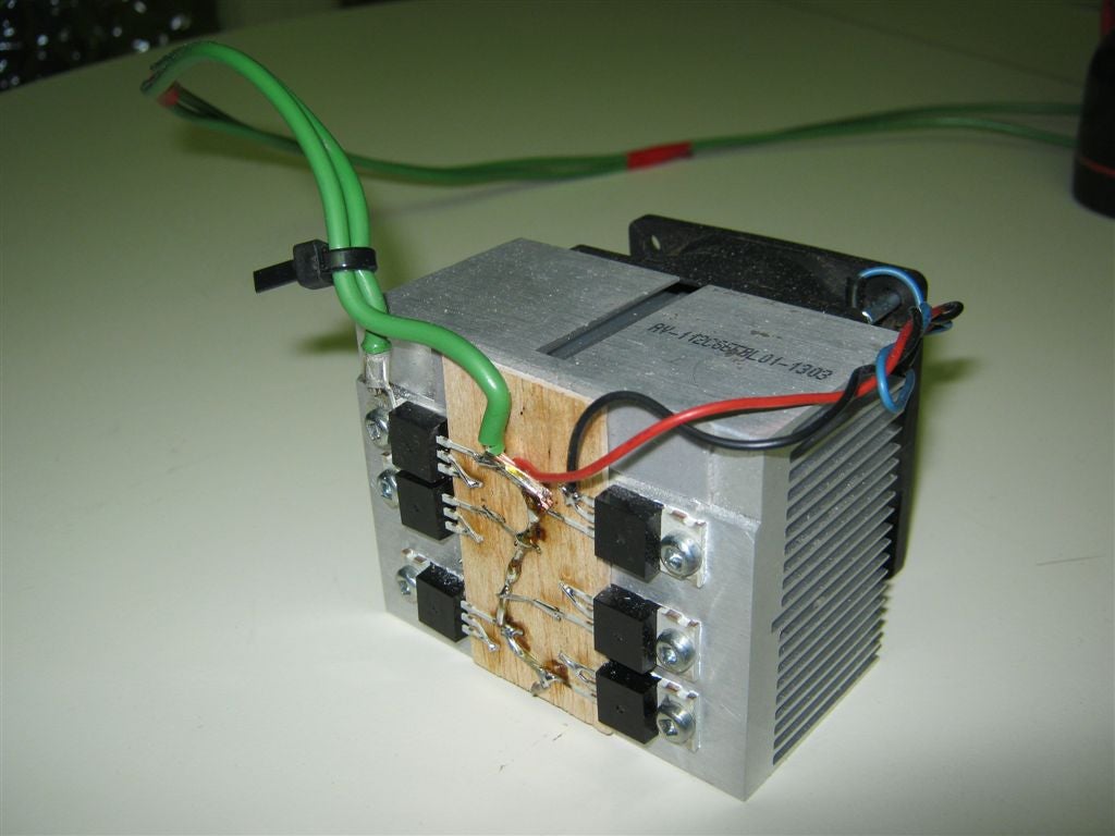

Does anyone know if I can use an external dummy load such as these in the Discharge+ mode:
http://www.rcgroups.com/forums/showthread.php?t=1352331
on the iChargers ?
I know it is not a resistive load, as say a halogen bulb is, but it is a cheap way (cheaper than bulbs !!!) to get a lot of power dissipation. I had a play around with a LM388K today and for a few bucks can dissipate 5.0A with one component.
The regulator requires the battery load to be plugged in one end and dissipates the power in the IC, I can't see how I would be able to use it as an external discharge source with the iChargers. Does anyone know if it can be done ?
The voltage reg constant current sink circuit I am running is attached below.
I am able to get about 4.0A running a halogen 50W bulb but would rather use the LM317 / LM338 if possible.
Regenerative discharge would be a better option. There is a lot of posts regarding this in this thread.
Fred
I built a similar unit and never was able to get the discharge mode to work with it.
Because it is not actually a load till it is powered up.
So I use it in MONITOR mode.
It sounds loud enough when the set point is met.
I have since added a fan on top.
