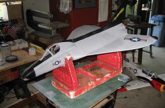

It looks real for sure!

I used an initial coat of water based polyurethane, after which the foam is sealed sufficiently to withstand any paint you might choose. I used inexpensive spray can paint from the hardware store. Look on 6mm's site for downloadable decals.
Control throws, expo settings, CG location and tips on painting are all included in the instructions. The bay in the front of the nose (which I forgot to photograph) will hold 3x2100 LiPos. With them in front and the electronics inside the aft fuselage, the plane balanced without additional weights.
