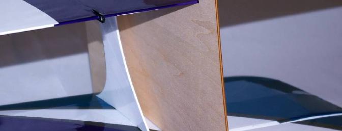

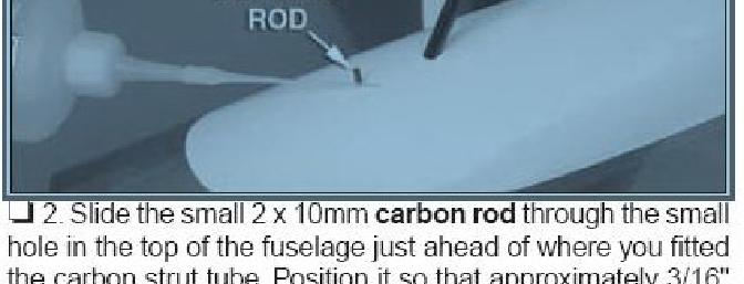

Page ten of the assembly manual covers the mounting of the upper wing strut, and it instructs you to insert the 5X120 mm carbon strut that will eventually slide up into the top wing and get glued in place. Step two instructs you to insert the little indexing pin into the fuselage and glue it with CA. I used thin CA and apparently over applied it.
When instructed to push the 5X120 mm carbon rod up into the upper wing, I could not budge mine. Apparently a little CA had run down through the small indexing pin hole and found it's way to the 5X120 mm rod. The end result was that I could not slide this large carbon rod up into the upper wing, so be careful when gluing the "indexing" pin for the upper wing strut may be in order and be very sparing with the CA.

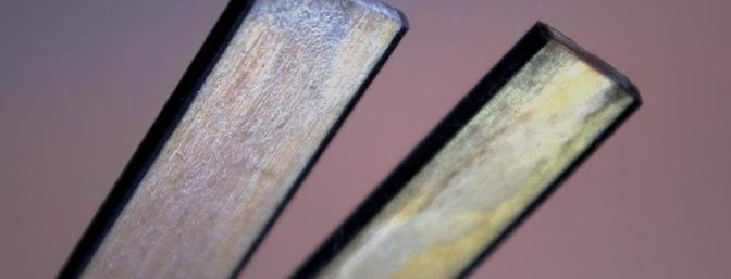

There are two lower wing joiners that will connect the two halves of the lower wing. I really liked the way Great Planes constructed these two pieces. They are ply, but they have thick carbon fiber bar stock as edges. There is an addendum to the manual that gives the assembler a heads up that these two joiners are not identical, so they are not interchangeable and must be inserted into the correct slots.
Since the assembly manual details the use of 30 minute epoxy when inserting these joiners, the lower wing is obviously not meant to be removable. I personally do not have any problems with the permanence of the two wings. Overall, the Reactor Bipe is not so large that this is a problem, and once you complete the attachment of the wings, they are once and for all perfectly aligned and at the right incidences. The included wing assembly jig all but guarantees that you will achieve this perfection.

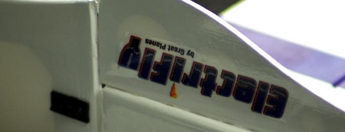

As I began to populate the airframe with the electronics and power system, there were several items worth noting. It is necessary to bring the leads for the two aft mounted servos forward for connection to the receiver. This is done with the recommended 12 inch servo extensions. There is definite variation in the length of the servo leads that come on the different manufacturers’ servos. The problem is that the combination of the Futaba 3114 servo lead with a 12 inch extension just barely reaches the receiver compartment on the Reactor Bipe, and going up in size to an 18 inch extension would result in a relatively huge wad of excess servo leads stuffed into the rear of the fuselage.
The included motor mount adapter is designed to work specifically with the Great Planes motor listed. The dimensions of the recommended RimFire 35-36-1200 were obviously taken into consideration when the firewall and motor box were laid out. It fits perfectly, and the spinner backplate to cowl clearance is just right. I also really liked the way the Electrifly 35 ESC slid into the thin cavity that exists just above the battery area. Great Planes also provides and recommends a two stage Velcro retention system to ensure that the battery does not suddenly shift position during the extreme maneuvers this plane is sure to experience.

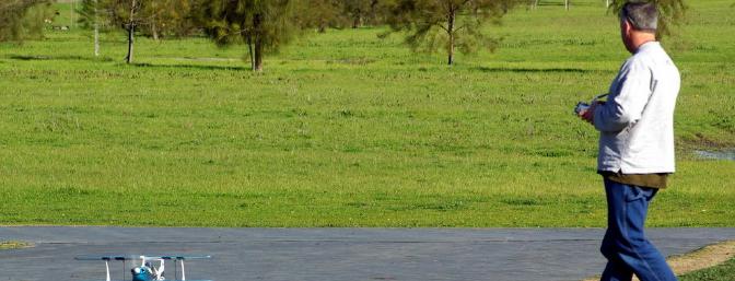

I knew before I ever taxied out for my first take off that that very short take off rolls would be possible with this plane and power system. The winds were blustery and a slight cross wind component existed on the evening I decided to take her out for a spin. I abandoned the long take off roll concept the instant I heard the sound of the tail washer on the two laned asphalt road where I did my first flights. Subsequent take offs and landings saw me carry the plane instead of taxing it any further than I absolutely had to, since it is tantamount to the sound of someone running their fingernails down a blackboard.
My next outing had me flying off of a runway composed of a plastic tarpaulin stretched out tight and anchored. On this surface, the sound of the washer was not the least bit audible.

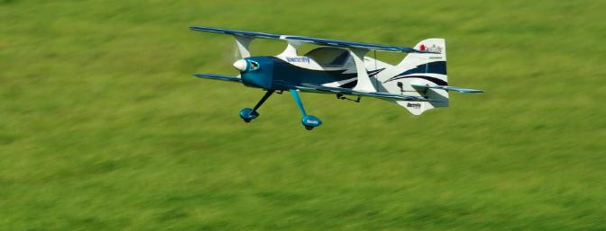

As expected, the huge rudder provides all of the authority you will ever need to swing the fuselage around while on the ground. The ground tracking is straight and true. It takes a very light touch on the rudder, even on high rates, to keep the Reactor Bipe pointed right down the center of the double yellows.
The slow speed performance of this plane is absolutely outstanding! With a slight headwind, I was able to float it in and settle ever so lightly on the mains and washer. It will slow to a walking pace, with no sign of any tendency to drop a wing tip. If you find yourself a little short of the threshold, it will only require one or two clicks of throttle to extend the approach until you are over the numbers.

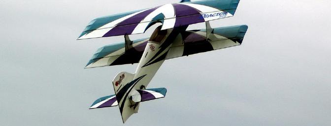

The Nintendo generation seems to have a real knack for flying 3D without even trying. Well, in the same way that you would perhaps line up to buy a hot new title for your Xbox or PS3, I suggest you snag a place at the front of the line to grab a Reactor Bipe because the moment you bury the throttle stick full forward, it just "feels" oh so right.
This one is capable of anything you want it to do. It is heavier than the typical park flyer, weighing in at two and a quarter pounds, and it is definitely sturdier than many park flyers. The airfoils are thin allowing the Reactor Bipe to retain a lot of energy. The huge control surfaces give ample deflection to throw it heartily into any maneuver you desire.
As one who is continuing to slowly develop my aerobatic and 3D skills, I instantly fell in love with this one. The Rimfire is a great match for this airframe and provides ample power to not only hold a hover nicely, but to punch out when things go a little wrong. Knife edge takes but a touch of rudder and the coupling is minimal. I kept over applying the rudder and climbing on my knife edge attempts leading me to believe that it just might be possible to knife edge loop this one. The fuselage's thin dimension and taper bears homage to pattern designs, though in a much smaller package. Even in a fairly gusty wind, the Reactor showed amazing stability. High alpha flight is stable, with nary a wing rock evident. Taking it up high, killing the throttle completely and applying full up elevator results in a beautiful elevator. Snaps on high rates are violent enough to land you a night in the pokey on wanton destruction charges, but the Reactor airframe does it all without complaining.
