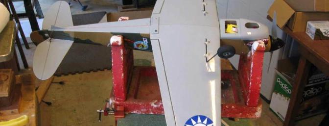

All in all, assembly is simple and straightforward. Everything fits, and the result is a strong and solid structure. Is it Almost Ready to Fly? You bet.
The wing consists of two prefinished halves. Hinge the ailerons, join the wings, install the aileron linkage and that's it.
Tail
The tail surfaces are sheet balsa. Hinge, attach control horns and install. That's all.
The pushrod connectors supplied are a type I have not seen before, with an Allen head setscrew to retain the pushrod and a knurled thumbnut to attach the connector to the control horn. I like these a lot, and I also appreciated that the needed Allen key (along with a second one for motor mount bolts) is included in the kit's hardware. Please note that I deviated from the hook-up in the Instruction Manual because I don't like Z bends and use Dubro connectors. Great Planes recommends that you follow their instructions, especially if you are a beginner.
The fuselage itself is completely prebuilt and ready to go. It is left to you to build the motor mount and motor and install the electronics.

There is plenty of room for your radio equipment. The recommended large 3000 mAh LiPo battery fits snugly in the nose, and the receiver rubber banded to its own mount is a nice touch.
All of this is well planned, but once the battery is connected and the wing is bolted in place, the airplane is "hot", the safety features built into ESC notwithstanding. An external on/off switch would be a wise safety feature to add to this setup.
The cockpit and cowl are both prepainted. The instructions show a large air inlet cut into the bottom of the cowl, and I followed the instructions as intended for this review, but I'm not convinced this is really necessary. Left to my own devices, I would have tried using the cowl as-is unless trial flights proved the vent necessary since there is lots of airflow through the face of the cowl.
By e-standards, the landing gear seemed heavy, but when you realize that this airplane's wing loading can be up to 27 oz/ft, and since it is a warbird, it is probably not wise to slow it excessively on final approach to landing. The robustness is clearly necessary.
The recommended C.G., 1 1/2" back from the wing's leading edge where it meets the fuselage, struck me as oddly far forward, but in flight it seems just about right. Maybe because the wing is so sharply tapered, the "forwardness" of the C.G. is an illusion. I suggest you use this position at least for your initial flights.
