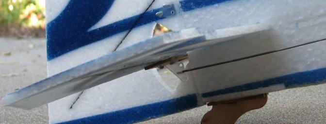

As with any airplane, you have to make sure the horizontal stabilizer is truly horizontal. Ours was quite low on the right side, and sanding the opening in the fuse didn't fix it. We decided to straighten it by jamming a 6d nail into the crack on the right underside of the horizontal stab, gluing it in place, and filling in the resulting gap with white glue. White glue doesn't shrink or expand, so once it had dried we could remove the nail and the stab was perfectly horizontal.

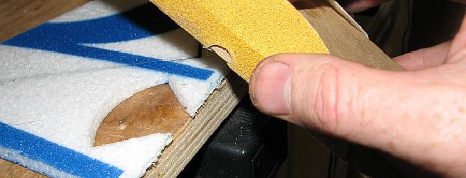

Attaching the control surfaces requires sanding, or as Spackles94 chose to do on the Double Time, slicing a 45 degree angle into the leading edge of the control surface. Spackles94 was troubled by the fact that sanding the control surfaces left their leading edges slightly rounded rather than a flat 45 degree angle; we were not bothered by this. Which is to say, sanding does leave the edge rounded, and we chose not to be bothered by it.
Aside from that, all you have to do is cut your hinge slots and glue in the hinges. "Oh boy, we get to cut hinge slots!" There's something soul-suckingly, hideously, mind-numbingly tedious about cutting hinge slots. There are 15 hinges on this airplane. That's 30 hinge slots that have to be marked and cut. Yeah, we're whining, but WE DON'T LIKE to cut hinge slots.
Aside from cutting hinge slots until your brains start to drip out your ears, there are a couple of potential gotchas when attaching the control surfaces. The instructions say to use epoxy to attach them, which seems odd. Why not use CA like everyone else? We are careful to follow the directions when building a plane for review, so we couldn't say if CA would have worked successfully, but epoxy works fine and is only a bit more trouble.
And when attaching the ailerons, pay careful attention to the instructions: specifically, put the inside hinge 3/4" from the edge. We breezed past this instruction and put our innermost hinge a good 1 1/2 inches in. We discovered the importance of proper hinge placement once we attached the control horns: pulling the aileron up was no problem, but pushing it down just warped the aileron and pushed it away from the wing more than down. The hinge has to be very close to the control horn, or you will lose a LOT of your aileron throw. We had to retro-fit two additional hinges right near the control horns to solve this problem.
