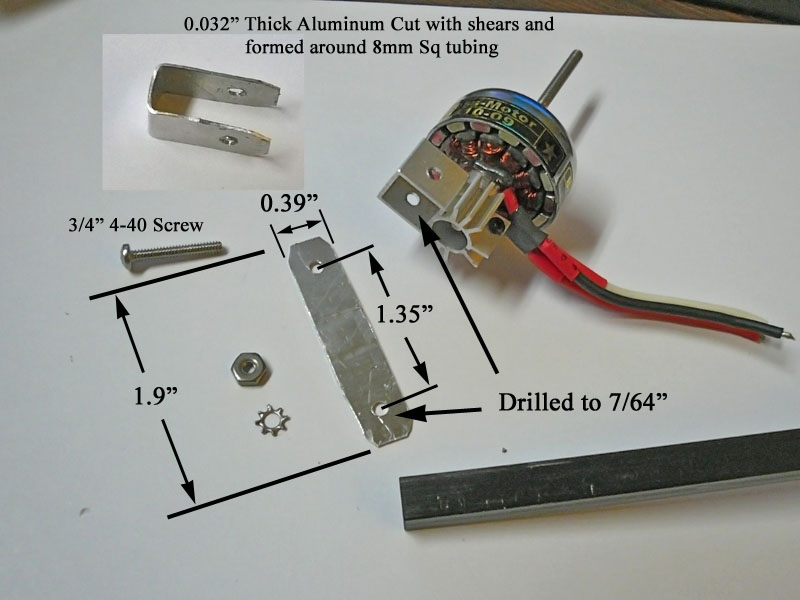

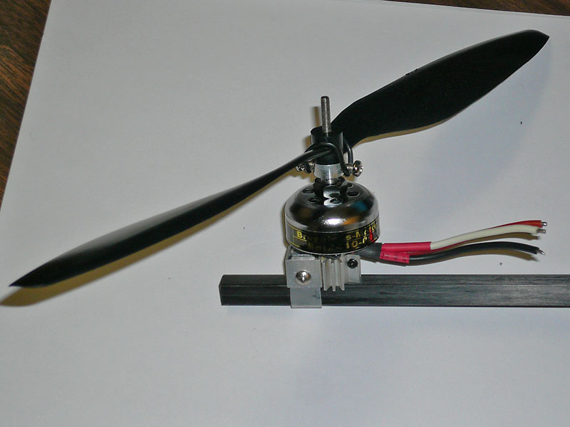

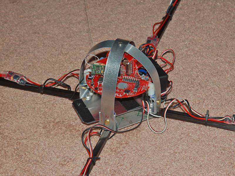

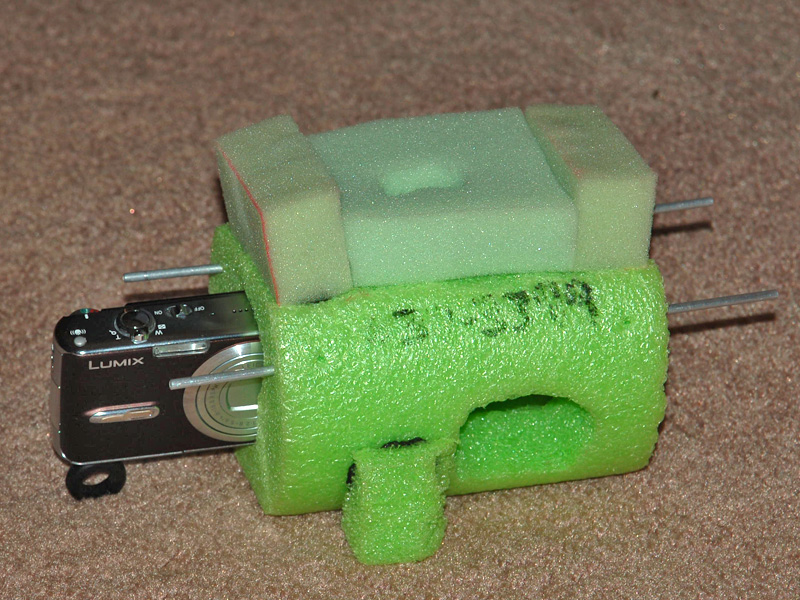

A New 1000mm Quad Copter Design
I would like to present my 1000mm Quad Copter design based on a newly available $375 Controller PWB. The Controller PWB is a brushless redesign by the designer (Mike Dammar) of the Draganflyer Quad Copter.
The platform with motors and ESCs for the 1000mm Quad Copter shown can be built for approximately $125. The total cost of approximately $500 (plus a little time with a Dremel tool) provides the following:
1) Adjustable motor to motor spacing from 370mm to 995mm. I set it for a 650mm spacing (325mm from prop center to platform center) as shown in the photo which prevents the props from hitting the ground at any angle up to 90 degrees.
2) Weight 18.8 oz without battery. A two min test flying outside with a 30 ounce system (8.1 ounce payload with 3.1 ounce battery) averaged 88 watts.
3) Very resistance to crash damage with the mix of aluminum and two 1000 mm carbon fiber square tubes. Very easy to repair since no holes are drilled in the carbon fiber tubes and aluminum screw clamping is used. No plastic parts to break.
4) Outrunner Motors cost less than $7 with the mounts and have a maximum power rating of over 100 watts. Maximum lift for the 1000mm DF is over 70 ounces. I had no problem flying it inside my 10’ x 10’ room loaded as a 60+ ounce system (that is more than 2 lbs of payload!)
5) Flying is much smoother and more stable than the smaller frame quads I have flown. Note that the controller board includes a Thermal Intelligence module to help keep the unit level. Here’s a little bit of no-hands flying:

The pictures below should give you a rough idea of how it is constructed. I also included a power chart which might be a little difficult to read with the two axis. Note that one of the data points is a 9 minute flight with a 1320 mAh battery carrying a 8 ounce payload including my Panasonic Video/Still camera and foam mount (30 ounce flying weight).

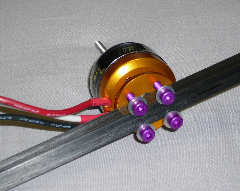

Alternative mounting approach for the "Gold" version of the -09 motor:

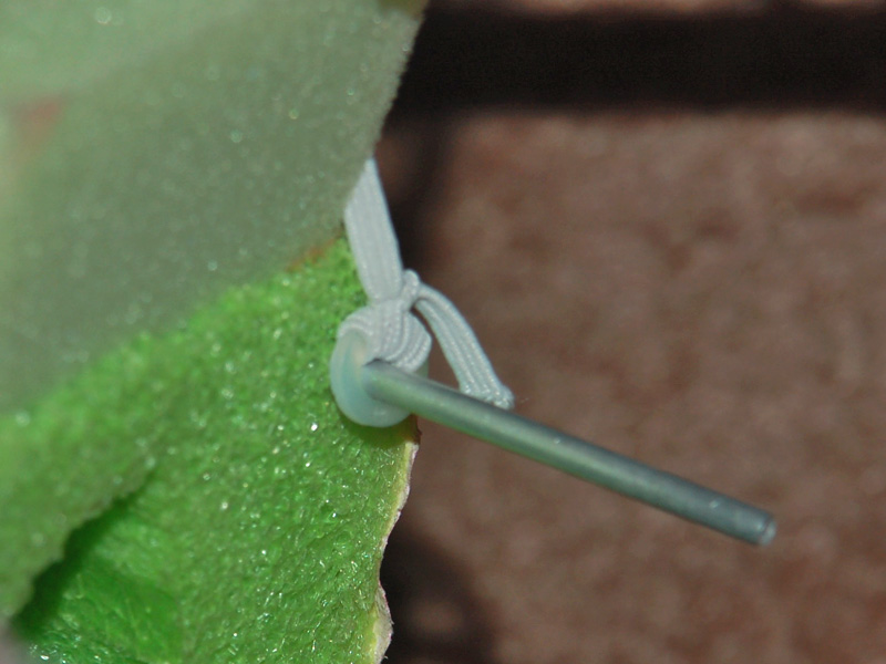

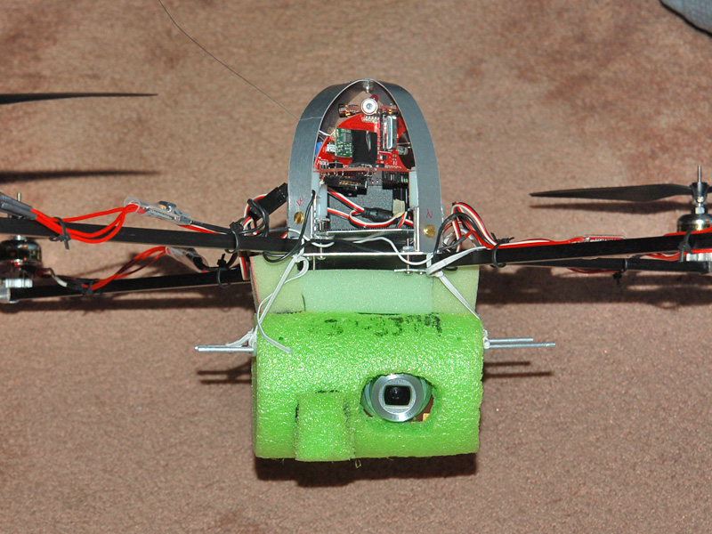

I'm not sure there is much interest but here is a video showing the new 1000mm Quad carrying a video/still camera payload and the resulting video from 120 feet:
Flying Quad VIDEO
And here is a sample still shot:

Thanks for showing such detailed and close up photos of your frame. I was wondering how one would mount a TowerPro motor and you gave me the answer!
In one of your videos it looks like you have some sort of foam mounted on each arm and underneath the frame. Could you provide some photos and more information about what you are using and how it is mounted?
I'd also be interested in more information about how you built the little cage around the electronics in the center of the frame.
Also, I'm curious about what other sensors the PWB uses. What type of gyros does it use? Are they the ADXRS300's like the UAVP, MLX90609's, or something else?
Hi Magellan,
The bumpers and camera mount are made from a kid's foam stick used to play in a pool. They sell it in 6 foot lengths for a few dollars. I use soft stretch elastic (used in clothes) tied to nylon washers which slide over the aluminum tubing. The mount is then suspended just below the Quad to reduce any vibrations from the motors. The pictures show provide enough detail on how it is used. During the early development period, I had several crashes from 100 feet and higher without damage to the camera.
The RollCage is made from 0.025 inch aluminum sheet cut into two strips 0.7" wide. The strips are bent to shape and secured with 4 screws and a center screw. Not much to it but it does an excellent job protecting the PWB and still allowing the TI sensors a clear view.
The Gyros are labeled as ENCO5EA9 but I have no details.
Old Man Mike is online now Find More Posts by Old Man Mike   Reply With Quote

Hi Mike,
Thank you for the detailed reply!
I like the innovative use of the foam sticks and elastics. I'll have to consider using something like that to shield a camera when I get one in the air. It sounds like it provides plenty of cushioning should a fall occur!
