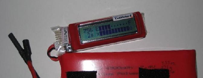

Hobby Lobby has introduced the CellMeter, a great little "Gas Gauge" for your LiPo packs. This handy little device is available in two models, the LBC400 "CellMeter-4" and LBC800 "CellMeter-8", capable of checking up to 4 and 8 cells respectively. Hobby-Lobby generously provided the 8-cell version for this review.

The CellMeter has an exposed-pin, 0.1"/2.5mm spacing connector, which fits the majority of manufacturer's balance connectors. Hobby Lobby can also provide adapters for the smaller Thunder-Power and Flight-power balance connectors. You use the CellMeter by simply plugging it in to a balance connector. You must use caution to ensure that you observe the correct polarity.
Some balance connectors use an unconventional pin layout, so that one or two pins are 'skipped' between the negative connection and the positive of the first cell. A very nice feature of this device is that you do not need to reconfigure those balance connectors, it will detect the "missing" cells and work correctly.
The CellMeter allows you to quickly to determine the battery charge state from an LCD screen that displays an analog "fuel gauge". It also clearly indicates the balance condition of the cells with a similar analog indicator. The pack voltage and cell-count are displayed alongside these gauges, and this first screen is all you need to check packs before flight or charging.
For more detailed information about a pack, more screens can be accessed by pressing the small button located underneath the shrink-wrap, below the balance connector. The CellMeter first displays the number of cells, the total voltage of the pack to one-thousandth of a volt, the percentage of charge, and the individual cell voltages to one-hundredth of a volt.
A third screen is displayed by pressing the button again, and this time shows individual cell voltages to one-thousandth of a volt. If there are more cells than can fit on the display, the cells are split between two screens, and the display indicates which "bank" of cells are being shown.
The CellMeter-8 has one feature that is not available on the 4-cell version. It has an additional screen which displays the voltage of the highest and lowest cells, along with the difference between them to one-thousandth of a volt.
If one or more cells' voltage is below 3.0 volts per cell, a warning message will flash on the LCD screen and an alert tone will be heard. A similar warning is provided if any cells' voltage is above 4.24 volts.
If cells in a pack are out of balance, the analog balance indicator will immediately reflect this. If the voltage difference between cells exceeds approximately 0.1V, another warning message is displayed along with an alert tone. The individual cell voltage and voltage difference screens come in handy for allowing quick identification of the suspect cell.

Is the % of power remaining simply calculated from a comparison between measured voltage and what fully charged voltage would be for a pack of that cell count?
mexico is offline Find More Posts by mexico
Old Nov 07, 2007, 12:57 PM
RIP Ric
Andy W's Avatar
Marietta, GA
Joined Jun 1999
43,272 Posts
I would have to assume so, yes - no different to the on-board monitors that indicate the charge state with a tone when connected..
