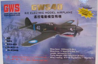

Wingspan:39.4"
Wing Area:272.8 sq. in.
Weight:23-26.5 oz.
Length:33.1"
Wing Loading:- 12.8 oz/sq. ft.
Servos:4 GWS Naro or HS55 sized equivalent
Transmitter:4 channels
Receiver:Micro
Battery:3 cell 1300-2200 LiPo
Motor:GWS BL2215/126
ESC:GWESC25A
Price$104.99 with motor and 4 servos
Manufacturer:Grand Wing System China, Inc.
Available From:Grand Distribution

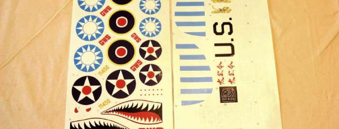

Tearing into the box, two colorful sheets of decals jumped out at me. You can dress up your '40 as a Flying Tiger, as a British lend-lease version, or in U.S. Army garb. There are decals for all three versions. These are waterslide decals, but they slide on easily with nary a tear or problem.

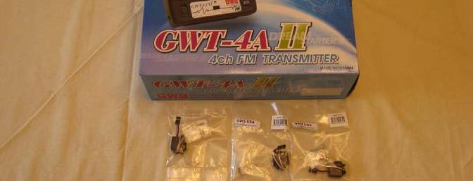

GWS also provided me with their GWT-4A II transmitter and RD-8M/SS/H receiver. This equipment should be quite adequate, however the supplied transmitter was not compatible with the supplied receiver. Rather than slow things down waiting for an equipment swap, I went ahead and used my own JR equipment. I did, however, use the supplied GWS servos and the GWESC25A ESC.

The GWS box says "for intermediate to advanced fliers." In my opinion, intermediate for sure, advanced, not necessarily. If you are comfortable with a low winged aileron equipped airplane, you will be well off with this one.

  • Generous supply of decals
