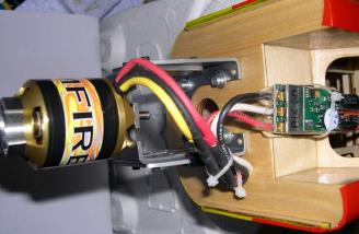

Motor/ESC Installation
I also chose to install an arming switch to allow me to mount the batteries plugged in with the bottom hatch attached. This comes in handy since the batteries mount from the bottom. When it's time to fly, I simply turn on the transmitter and plug in the arming switch.

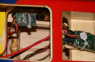

Receiver, BEC and Servo Synchronizer
The receiver and servo synchronizer are installed under the canopy deck. The manual instructs you to cut the covering on three sides and peel back from the deck, and reattach the covering after installing the radio equipment. I chose to remove the covering and then apply black trim sheet to give a black interior to match the included decals. The receiver used for the review has been discontinued and the suitable replacement is the Futaba R617FS 2.4GHz FASST 7-Channel Receiver.
I installed the Sport BEC just aft of the ESC above the bottom hatch.
After installing and connecting the receiver, BEC and servo synchronizer, I applied the included instrument panel decal and a piece of black trim sheet over the deck.

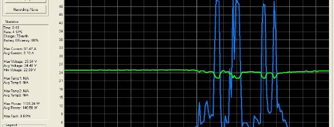

I'm very happy with the power setup on the Reactor. I had my doubts that the 9.5 oz. Rimfire 42-60-480 was up to the task, but it has proven me wrong. The Great Planes ElectriFly LiPos (two 11.1V 3200 mAh 20C in series for 6s) are holding voltage well to supply plenty of electrons to the Rimfire motor, which provides more than enough power to 3D the Reactor with authority. Just make sure you use the supplied wheel collar and attach it to the shaft right next to the retaining ring as the retaining ring could pull away from the groove as it did on my setup. I really like the Xoar 16x8 electric wood prop and find it to be very efficient. The Reactor came in at an all up weight of 95 oz - that calculates to 191 watts per pound! See data from static testing below.
