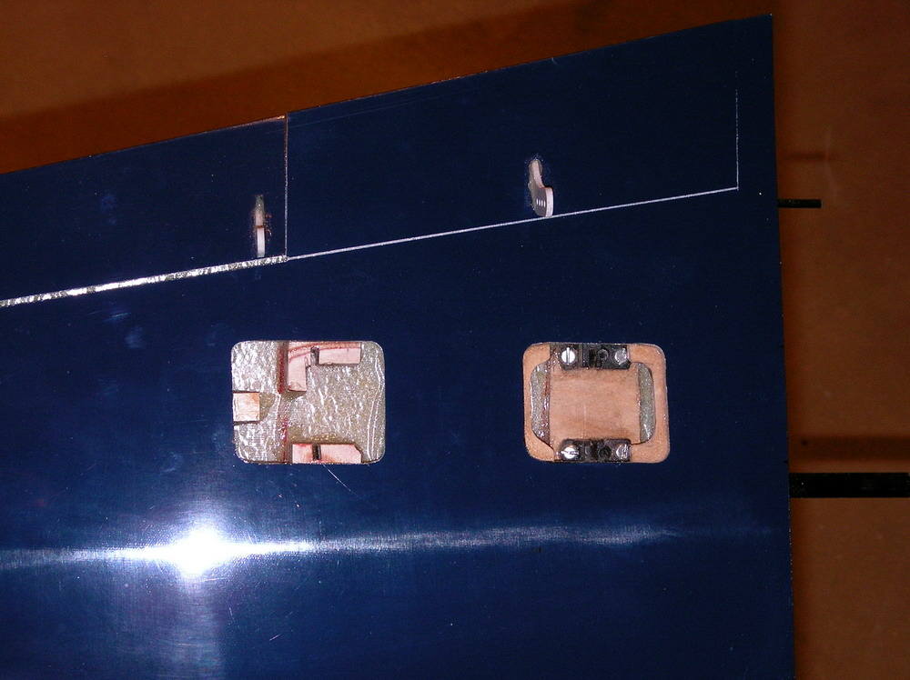

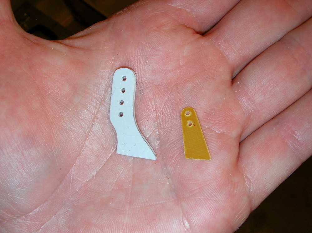

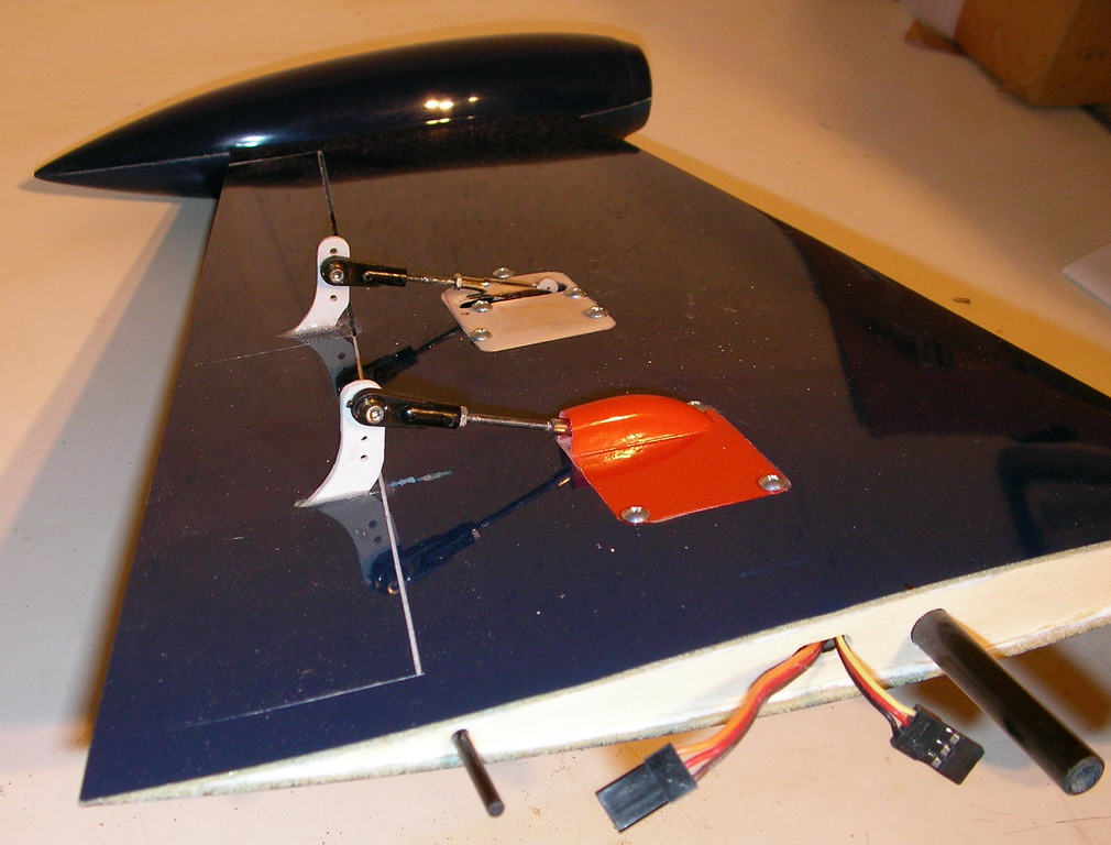

First, we decided to add Flaps. Indeed, due to the residual 200gr thrust, with the Kero-Twinjet, we were unable to land without totaly shutting off the turbine. We were hoping that the flaps will permit to land with the turbine at iddle (still 100.000 rpm !), even if we know that it is safer to land with the turbine OFF.

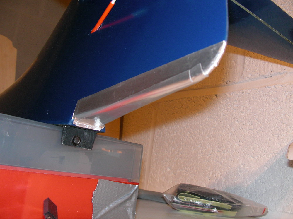

We also decided to make some new horns, significantly longer that the one provided in the kit, in order not to have to restrict too much the servo displacement (we wanted to keept maximum servo torke)
For the tail, we decided to use 2 servos (Hitec HS65 - 11 grammes) rather than only one bigger one. This gives added security and prevent to use a "Y-shaped" pushrod.

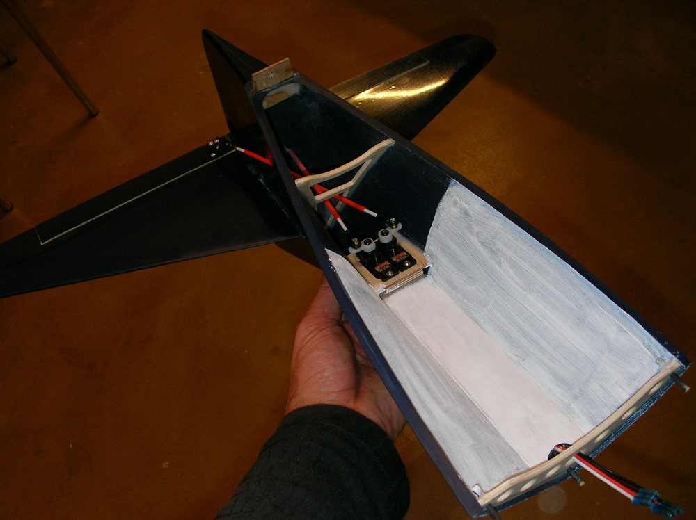

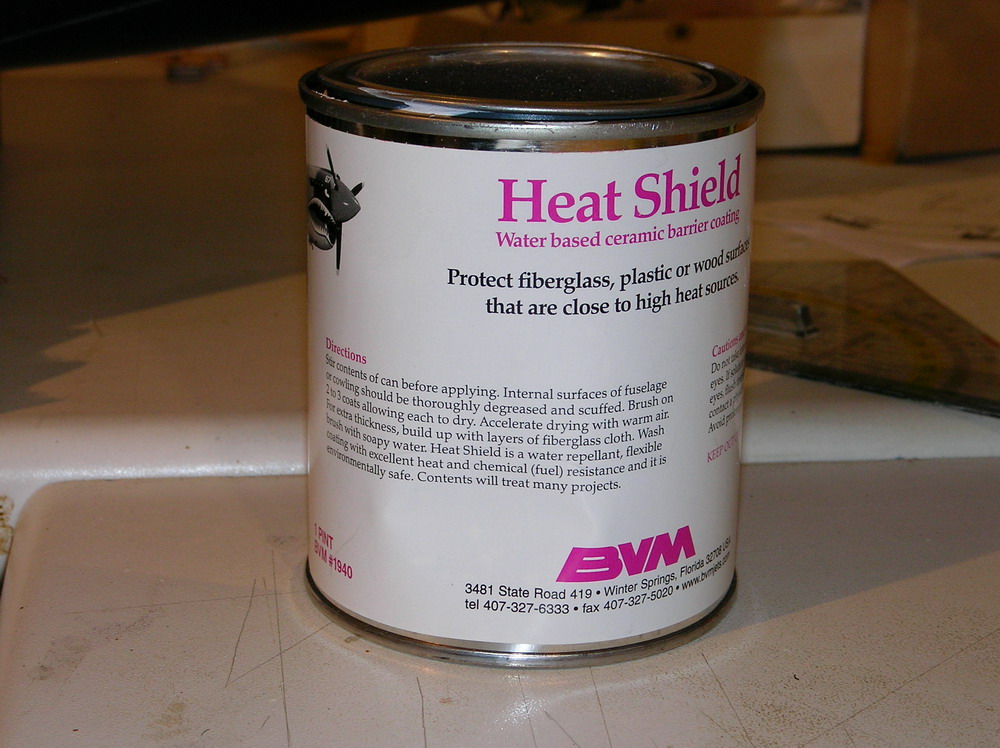

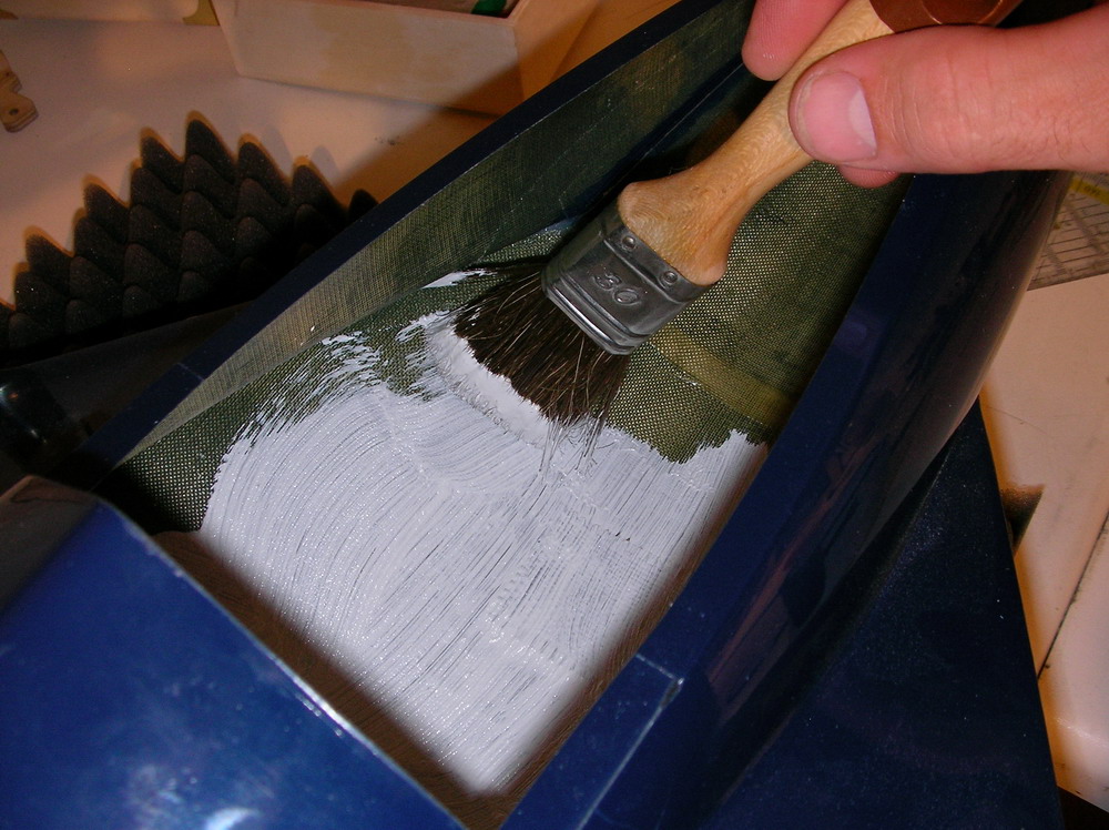

AND... we started to apply heat protection ... Inside (ceramic painting) and outside (3M Aluminium tape)

same painting in the rear fuse. Beware, ceramic paint is heavy. So, don't make too-thick painting.

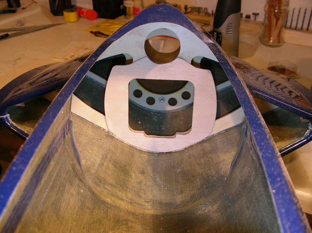

Take some strong ply-wood and make a nice mounting, for fixing the turbine into the fuse against the rear spar (at 90°).
and you fixit, using the 3 bolts already made by Aeronaut for fixing the EDF.

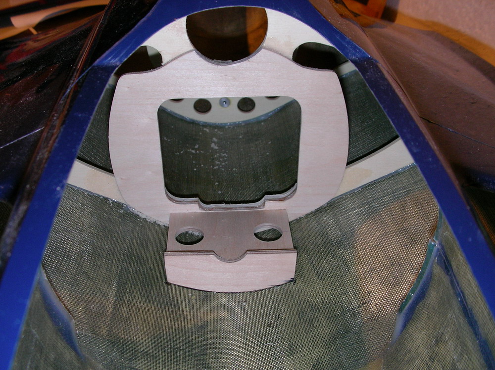

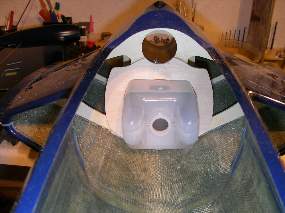

Now it becomes more complicated. You need to put a tank in the fuse (isn'it ?), but, since the tank weight varie quite a lot between full and empty, it can't be placed like lipos in the nose. Indeed, it need to be as close as possible to the GC in order not to vary too much the GC localisation during flight. So we had to cut a hole into the main spar, and to reinforce this spar with a 4mm frame fited around the tank. I use a 500cc Graupner Tank.
and a vue from behind

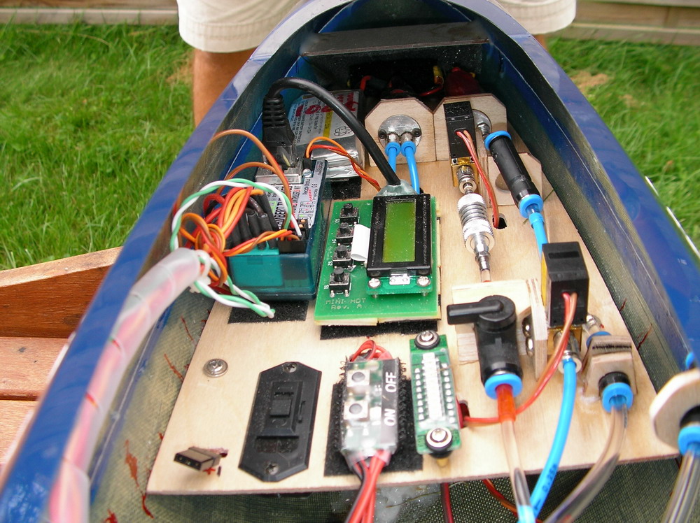

Now, we need to install all the turbine components in the fuse. We need to take 2 points into consideration:
1 - since there are no "heavy" lipos in the noze, we will need to put the installation as much as possible in the front of the plane in order to be able to ballance GC well without added weight. So, the 2 batteries are in front (RC & Pump batteries), followed by the 2 pumps (kerozene and... smoke system)
2 - we need the pumps and the ECU as far as possible from the receivers/antena. Since it is not praticable here to put the rx in the wings (as I did with the twinjet), we need to be carefull to spread the installlation in the fuse corectly. So Pump & ECU are in the nose and the 2 rx (yes, I use again the diversity system from ACT made of 2 4 channels Rx) are in the air intake.

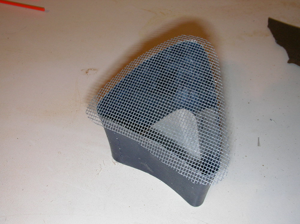

Now we need to install the Rx and connect the tank

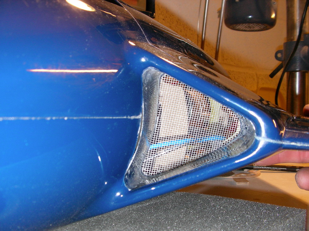

That is a LOT of connectors for 2 smalls 4 channels Rx ! (note: thanks to the diversity system, the 2 linked 4 channels rx becomes a 8 channels rx with 2 antenas. One antena goes to the whip and the other, positioned at 90° to the whip, goes inside the right wing. - See my Kero-twinjet built thread )
but also, we need to add a "filter" in the intake to protect the turbine

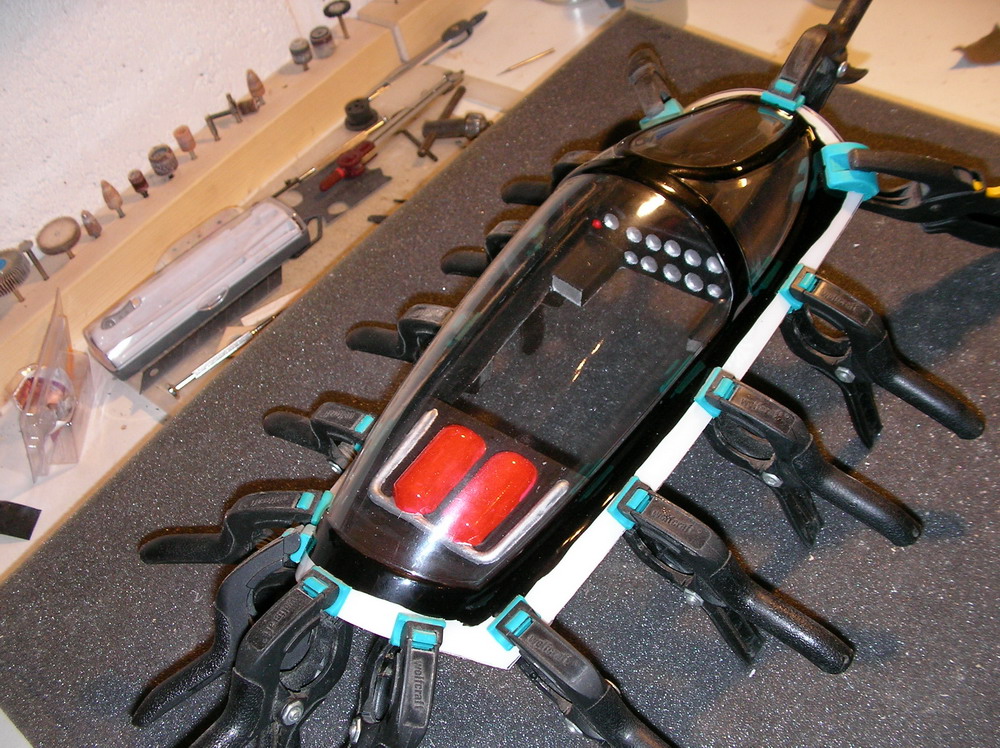

Now let's finish the cokpit (NO it is NOT a RC spider ! )

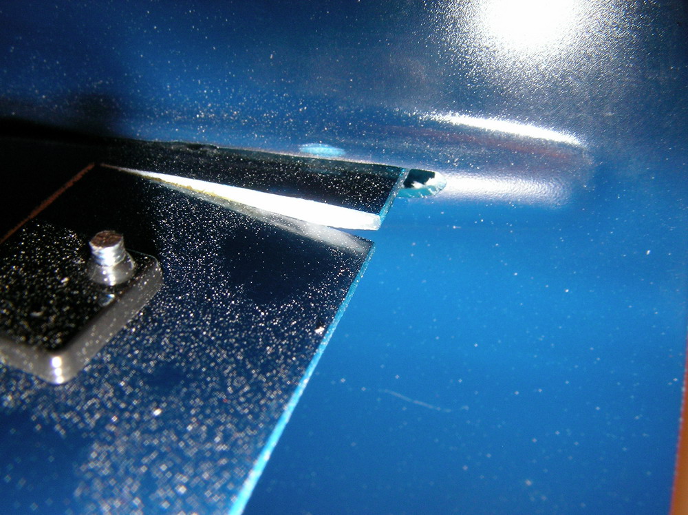

Just 2 mods :
We just need to put 1,5mm down trim, as aeronaut suggest in the brochure (we did not implemented this because we throught such big adjustment was a mistake, but unfortunately, no, it is needed . Believe it or not, bellow, this is the correct down trim )

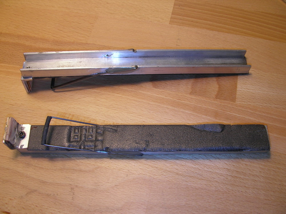

and we had to modify the rails that are used to avoid the nice underwing of the plane to be scrached by sliding on the ramp of the catapulte. Those springs are indeed needed because the rails stayed under the wing during part of the first 2 flights... I am not sure this is good for the flying caracteristics of the plane to fly with the 2 rails embarked !
so we are happy:

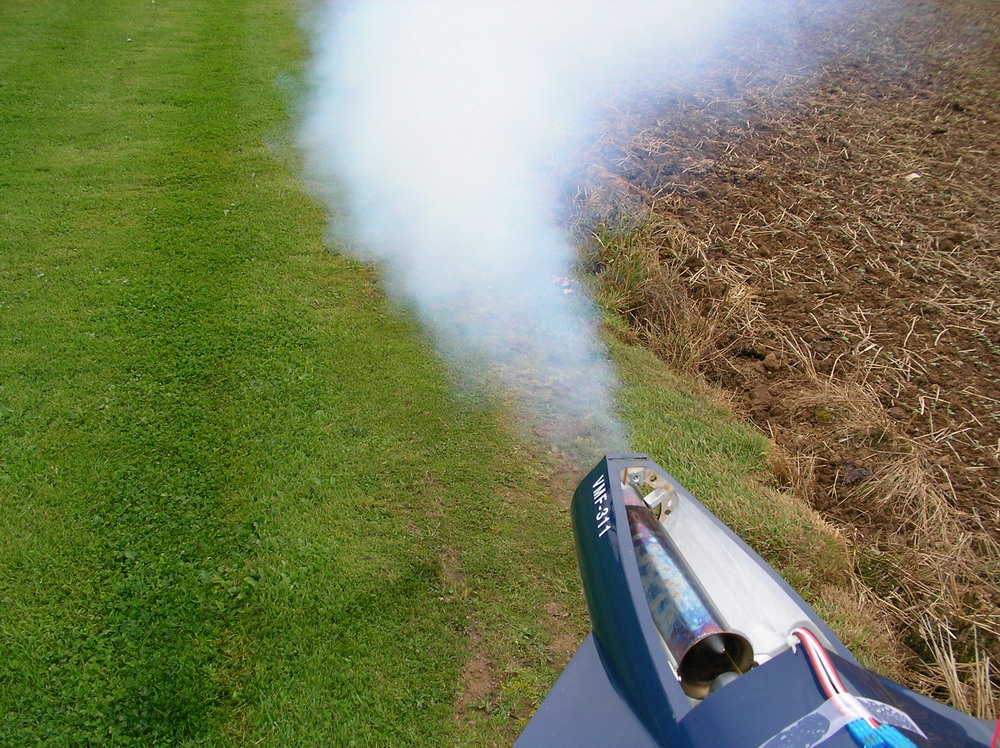

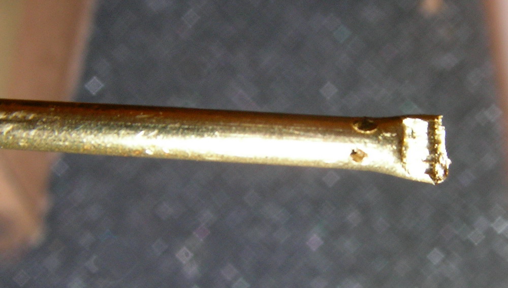

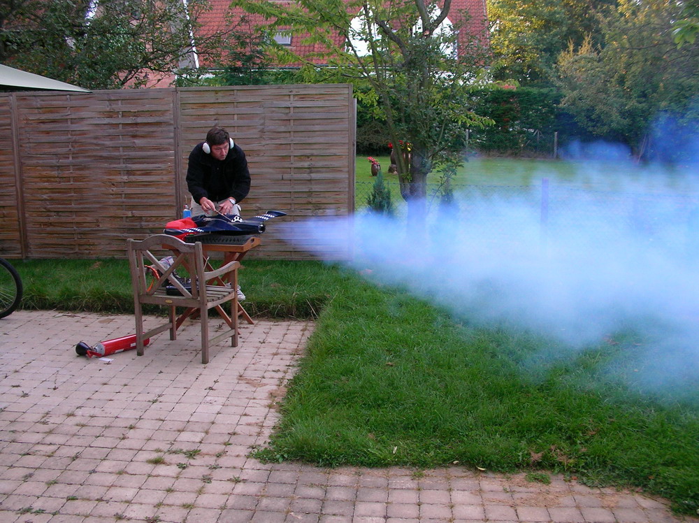

But this is not enough ! ! now we want smoke !
So, using a pump similar to the pump used by the Kolibri for the Kerozene, a 1mm (internal) brass tube and an old Speed-controler for brushed motor, we have made a "50 grammes + tank " complete smoke system (it used the same 2s Lipo battery than the Pump for kerozene).
of course a second tank is needed. We used an old 200cc tank, positioned above the Kerozene tank (still at the GC location)
And we need to inject the smoke liquid inside the thrust tube
The 'injector' is a 1mm brass tube, closed at the end, with 2 holes of 0,3 mm to difuse the liquid.
[B]Video of test for positioning the injector in the thrust tube
Video of test on the ground of the installed system.
Video of "in flight" smoke system
As you can see...In the sky, the result is not so good . OK, we had a cloudy day (so not good to see a white smoke), but also, the gazoline provide a light-gray smoke instead of a nice dense WHITE smoke. So now I need to experiment with other smoke liquid to get a denser and white smoke or may be do some more 0,3mm holes in the injector tube ? but I will loose pressure ?.
Any suggestions ?

Hello Bertrand, when you say gazoline for the smoke you mean gas for spark engines??
Here we use diesel fuel for smoke but the most dense is the one from 3w or Powerbox.
Juan.
chichisport is offline Find More Posts by chichisport   Reply With Quote
Old Sep 09, 2007, 04:40 PM   #12
Bertrand MICHELS
bmaaa's Avatar
Join Date: Nov 2003
Location: Belgium
Posts: 1,404
I mean diesel for the cars.
Thanks for the info, but which one give best results: 3W or Powerbox ?
Have you also heard about "Parafine oil", "Bio diesel", « B&B smoke oil » or l« MDW Super-di smoke oil ».
Do you have links for the smoke liquid from PowerBox ? (PowerBox do smoke fluid ??)
