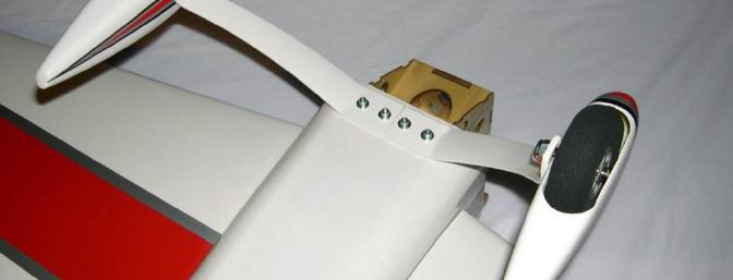

Landing Gear
I was really impressed with the weight, or lack thereof, and the strength of the two piece gear legs. The gear appears to be made from fiberglass. First, I installed the axles onto the gear with nylon insert lock nuts. The wheels are then held in place with a set of wheel collars. I slid the fiberglass wheel pants down over the axles and screwed them into place on the gear legs (on some kits the wheel pants are also held in place with the axle bolt, this is not the case with the Revolver). The wheel pants have the plywood retaining plate pre-installed and pre-drilled. To this point in my building career, I have never had a pair of wheel pants go on so perfectly or this easily.
The landing gear are easily mounted to the fuselage with a set of 6-32 bolts and washers.

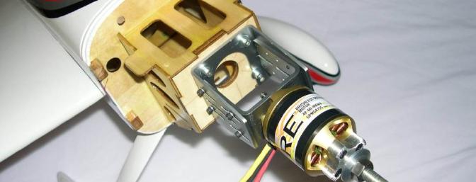

Mounting the power system to the fuselage could not have been much easier. Since the Revolver was designed from the start with electric power as an option, the guess work and possible frustration has been taken out of the build if you use the recommended equipment.
I mounted the motor to the aluminum mount with the included set of machine screws. The motor and mount attach to the firewall with a set of machine screws and washers. Make sure to use thread lock compound on the screws.
The ESC tray is glued to the bottom of the firewall/motor box with epoxy. I installed the Phoenix 80 controller to the tray with a strip of Velcro and secured the loose motor wires with a tie wrap.
The 6s battery for the Revolver is made by running two 3s pack in series. The manual recommends attaching the battery to the plywood battery tray with a set of tie wraps. I decided to also install a small strip of Velcro to the battery and tray floor to help keep it from sliding on the tray. Great Planes provides 2 additional battery trays in the kit for additional packs.
Note: Although the specs included with the Rimfire motor list it as having a battery limit of 5s lithium cells, It never overheated while running on the 6s battery pack recommended in the Revolver manual.
Below is a note from Great Planes' tech team regarding the Rimfire motor specifications.
The following is R&D's comment on this issue: While we have very specific performance recommendations for all the motors we have, please realize that the motor's limits were found during bench testing, which is the situation where the motor is loaded the most and when cooling is not optimal. The voltage was also supplied by the power supply, which means that it was constant throughout the run. Neither one of these apply when the motor is setup on a plane and it uses batteries. That is why we are "safe" to recommend a system that might be slightly above what bench testing suggests. When we do that is because we have flown the plane with that setup and we have confirmed that it was acceptable.
