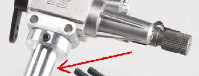

Opening a new era in O.S. 4-stroke technology, the FSa-56 is the first in the new "Ventless" Crankcase Series of engines. The 56 has the latest advancements for boosting performance, and it mounts with no-mod ease in the same space as the FS-52.
The F-4040 muffler is new also. In addition to less noise, it features a multi-positional tailpiece with a rubber O-ring that helps prevent oil leakage.
A newly designed lubrication system eliminates the need for crankcase ventilation.
Since the new design doesn’t have a crankcase vent, what happens to all the oil that accumulates in the engine? Let’s follow it as it makes its way out of the engine. First the oil is pushed into the center of the hollow crankshaft helped along by the pressure of the piston on the down stroke during the power stroke and the intake stroke. It then exits the crankshaft through a hole located in front of the rear crankshaft bearing and just behind the camshaft gears.
After lubricating the camshaft gears and the crankshaft bearings, the oil continues up the pushrod tubes into the valve gallery. In the gallery, the oil lubricates the lifters and the valves.
This is where the magic takes place. The oil is drawn into a small hole that exits into the space behind the intake valve.
On the next intake stroke, the oil is drawn into the combustion chamber along with the fresh air and fuel charge. Pretty neat! Not only is the oil “recycled” until it is burned, but it is pumped along through the camshaft gears, and into the valve gallery to provide improved lubrication to these normally oil starved areas. Way to go OS Engines! Look for this new technology to appear in many of their new four stroke offerings.
The 40NA carburetor is equipped with a venturi that reduces the chance of fuel leaking out into the cowl, while also creating more positive air/fuel flow
