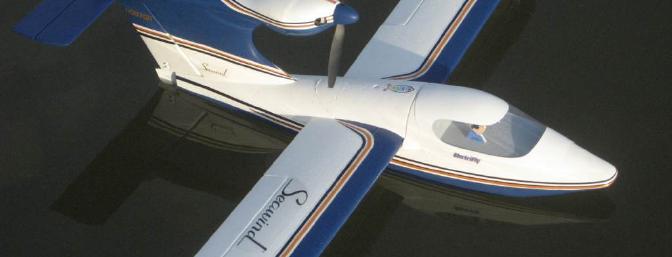

The full scale innovative Seawind came to America in 1989. From the outset, the Seawind was a bold concept. Built on the principle, "If it looks good, it will fly well,” the full scale Seawind does look great and flies even better. Extensive use of composite materials helps make the beautiful sweeping lines of the full-scale Seawind a reality.
The Electrifly Seawind EP model faithfully replicates those beautiful lines and the results are stunning. The best news may be that, just like it's namesake, this model flies even better than it looks.

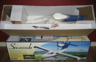

Kit Includes:
  • Molded foam fuselage with vertical stab and motor pylon molded in
  • Pre-drilled motor mount installed in fuselage
  • Pre-hinged and mounted rudder
  • Painted plastic motor cowl
  • Painted plastic and foam canopy with rare earth magnets
  • One-piece wing with hinged and rigged ailerons
  • Foam horizontal stab with pre-hinged elevator
  • Two wingtip floats
  • Elevator and rudder control rods and horns are pre-installed
  • Receiver antenna tube installed in the fuselage
  • Foam work and transport stand
  • Foam balancing fixture
  • Full hardware package including prop adapter, prop and 3 spinners
  • Excellent photo-illustrated 20-page construction manual

The Carbon Fiber wing dowel was difficult to install in the fuselage hold-down plate, but I tapered the front of the dowel and that fixed the problem. Once I got the wing into the fuselage saddle, I couldn't get the wing hold-down bolt started when I tried to bolt the wing on the fuselage for the first time. I measured and confirmed that the mounting hole in the fuselage was in the correct position, but it turned out that the tight tolerances of the kit required you to screw the mounting bolt most of the way OUT before you mounted the wing. If you backed out the screw until only 1 thread is showing below the wing, then assembled the wing on the fuselage being careful to make sure it is all the way forward in its saddle, the bolt would start every time. According to Great Planes, the problem was caused by a tight fit of the wing bolt in the wing. Owners of existing kits could solve the problem by simply removing the wing bolt and drilling out the wing hole with a 1/8" drill bit. Great Planes stated that future production kits will have this problem rectified.

The Seawind is a very stable airplane, and the first flight required only minor trim adjustments. When forced into a stall, it would drop a wing and then start flying again. Spins were very loose and hard to enter from level flight. Loops were nice and round and rolls were fairly axial. Stall turns were hard to get right. I then began to move the CG rearward and finally settled on a point that matched the CF wing spar location, and the Seawind started flying more like a pattern ship. Stalls were still gentle and the Seawind would slow to a walk for landings.
Taking Off and Landing on Grass
Even though the Seawind was designed as a waterplane, the manual suggested that it might be a good idea to try taking off from grass before you tried taking off from the water. A grass takeoff would allow you to trim the model for proper straight-and-level flight before you tried a water takeoff. You can see that the grass was pretty tall, but the Seawind took off just fine. "Grass" rudder was very effective. The Seawind was a pretty slick model and it took a while to bleed off airspeed, so I had to start the approach pretty far out in the pattern. Once close to the ground, I could begin to pull up the nose and let the plane settle in on the grass. The Seawind would then slide to a stop in about three feet.
Taking Off and Landing on Water
This is where the fun began. My first takeoff attempts were pretty bad. I tried everything I could think of from jamming the throttle to easing it up, flying the ailerons, and even mixing the rudder but I was met with only limited success. I was "going around in circles" a lot. The manual recommended holding some "up" elevator during takeoff to keep the nose up and keep the water rudder effective. The manual also recommended to "smoothly advance the throttle to full power" for takeoffs. I tried holding full "up" elevator throughout the takeoff run and slowly advancing the throttle, and what a difference! The water rudder was more effective, and the wing tips seldom dragged in the water. I finally settled on using high rates and full "up" elevator throughout the entire takeoff run for all my takeoffs. When the Seawind would just break off the water, I would ease off of the elevator a little to maintain a steady climbout. If I'd let off the elevator too soon, the plane would start skipping across the water. If I applied throttle before I applied elevator, I'd water loop. Check out the last video; using full "up" made takeoffs a non-event. Water landings were the same as grass landings. I had to start my approach pretty far out in the pattern because the Seawind takes a while to slow down. Once near the water, I could start applying up elevator to bring up the nose and let the Seawind settle in for a gentle landing. If I tried to land too fast, the Seawind would skip across the water till it slowed down enough to land.
Moving the CG to the CF wing spar location, really livened up the flight performance of the Seawind. Rolls were more axial and snaps were easy to enter. Stall turns became recognizable. Inverted flight only required a little "down" elevator. Inverted snaps and spins were spectacular! With a little power, they would flatten out - what a sight! But the Seawind would also stop its gyrations as soon as I neutralized the sticks. This was one fun little airplane to wring out. One interesting flight characteristic of high pylon mounted motors is that the nose of the plane will drop when you rapidly apply power. This was not much of a problem unless I was 6" off the water and decided to make a go around. If I was to firewall the throttle, I would probably make a big splash. If I slowly applied the throttle, the Seawind would accelerate and fly off as normal. It was not a big problem, just something to note.
