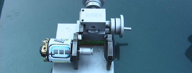

There is also a lathe feature for this charger. Lathing is used to cut the carbon off the commutator and to re-surface the area for re-mating with new brushes. It is a precision instrument that holds the armature in place and gradually moves it toward the lathe where the other knob moves the armature back and forth across the diamond tipped cutting knife. Below is a picture of the lathe with a motor installed.
