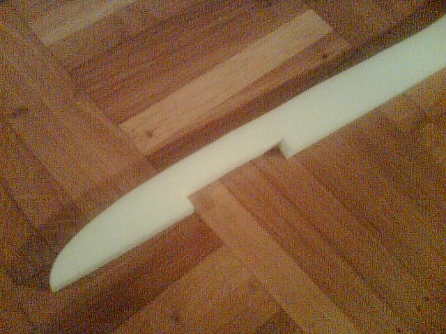

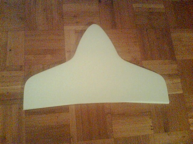

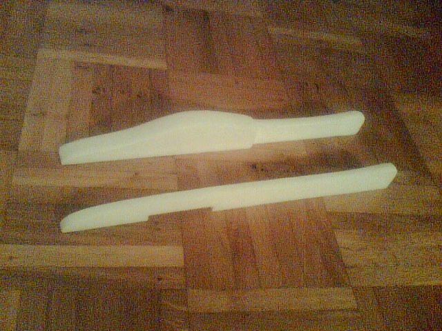

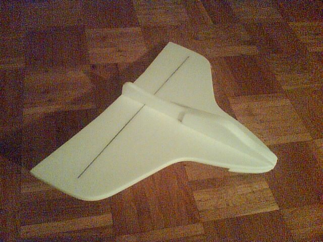

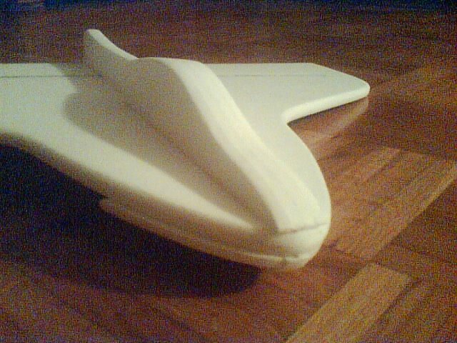

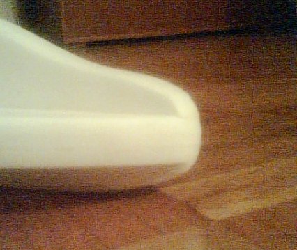

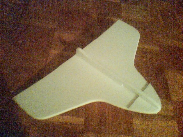

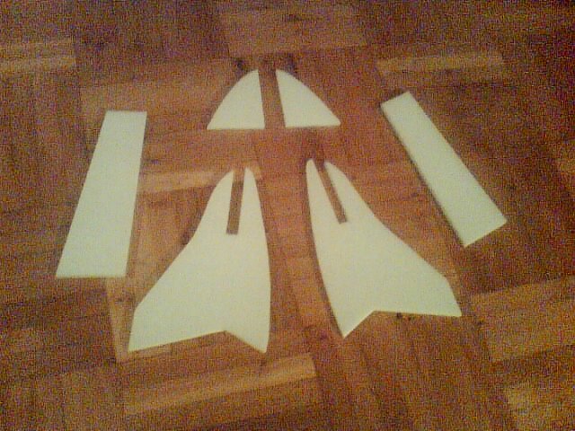

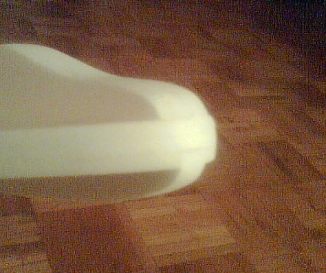

Nice wing, thanks for the plan ! I am just building my mini Cutlass. But instead of EPP I am using 6mm depron - 2 ply. Planned setup is:
- AX 1806N 2100kv Brushless Micro Motor (19g) from unitedhobbies.com
- ESC 12A 10g
- 2s LiPo 620 mAh
- 2 x 9g servos like SG-90 or HXT900
- micro receiver ca. 7g
- prop. ??? but max 7" :-)
A few photos from building:
