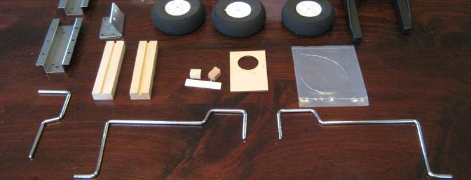

These parts were included in the kit, but were not used:
  • Aluminum 3-blade spinner
  • Landing gear mounts, landing gear and wheels
  • Adjustable engine mount
  • Fuel tank
  • Throttle servo mount

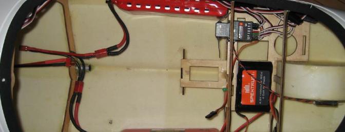

Radio Installation
I had been flying the Spektrum DX7 system in all my electrics for several months and had not used the full-range AR7000 receiver or the standard size DS-821 servos yet. I decided the Seawind would be an excellent home for the system. The tiny antennas fit inside the fuselage and did not require any hull penetrations like standard 72 MHz receivers. Seven 36" servo extensions made a real mess until I bundled them up and tucked them out of the way in the hull.
The aluminum wing spar was a very tight fit in the fuselage and in the wing halves. The rubber seal around the cockpit area was easy to apply and worked very well at keeping the water at bay. The canopy fit was excellent.
One of the challenges of the e-conversion was locating the proper CG. The CG given in the manual was for a gasser with an empty tank. On a gasser, as you fuel up and get ready to fly, you move the CG rearward a considerable amount due to the tank location. Because of this, the CG given in the manual was in the most nose-heavy location, and I should have been able to move the e-conversion CG back to an equivalent 3/4 full tank gasser point and have a properly balanced plane. Using a CG machine, I set the CG at 1-1/32" empty then put 13 ounces of weight in the tank area and measured again. The CG had moved to 2-1/8", so that's were I set the CG for the first flight.
