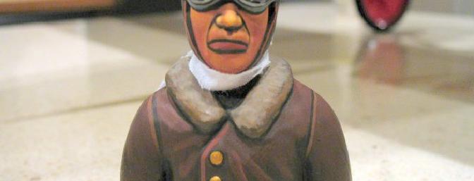

  • Paint the pilot

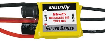

ElectriFly Silver Series 25amp ESC
  • Size – 40mm x 26mm x 8mm
  • Weight – 26g
My thoughts on the controller: The ESC performed flawlessly out of the box. It started and ran the outrunner without jerking, stuttering or hesitation. Considering the large props this motor spins, that is very impressive. It auto selects cutoff voltage and handled 4 servos with no issues.
The ESC is covered in yellow shrink-wrap. Wires on both the motor and battery end were very long. This is a plus! The ElectriFly Silver Series 25 ESC selects a cutoff voltage based on the charge state of the battery when connected. Make sure batteries are fully charged or your low voltage cutoff may be too low. Or do what I do - time your flights and never use LVC.
