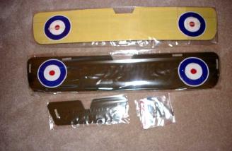

The Kit
The kit was packed beautifully! Nothing is worse than finding a broken part in a kit and that is very unlikely as nicely packed as this. All parts came bagged and securely packed in the box. Many of the small-bagged parts were in the boxes that held the fuselage in place and protected it during shipping.
The wings and tail feathers as well as the fuselage were nicely and lightly constructed and covered. The quality of the finish was excellent. I couldn't have done any better with the covering. I couldn't have done as well as they did on the fuselage! Ok, the covering was a bit shiny for the scale purist, but I liked it. The wheels and the undercarriage look terrific. The front cowling/radiator was very nicely done.
I was very impressed with everything I found as I unpacked the kit. I was tremendously impressed with the quality of the parts in the kit and for such a reasonable price.
