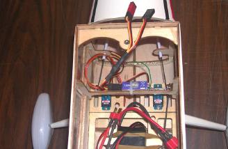

Radio Installation & CG
I had to do some hand bending of the forward landing gear steering control pushrod to allow the rudder servo to actuate the nose gear without binding, although the bending wasn't difficult too do.
Upon installing the battery in the recommended location, I found the model significantly tail heavy, so I opted to install a small mounting plate further forward in the nose for the battery. The photo below shows the battery in the recommended location. My final installation located the battery further in the nose, with Velcro holding the battery in place. Even with this battery location I ended up attaching about half an ounce of lead to the motor mount inside the cowling to achieve the recommended CG. One solution to eliminate adding lead: use PolyQuest 1800 pack instead of the recommended 1200 pack.
