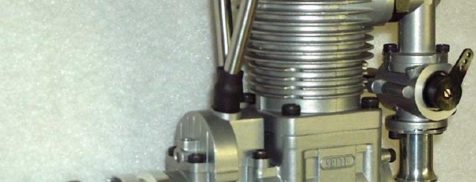

The Saito 1.80 Four Stroke
Type:Four-Stroke
Displacement:1.80 cu in (29.10 cc)
HP:2.8
RPM Range:2000 - 10,000
Engine Only Weight:31 oz.
Prop Range:15 X 8 - 18 X 6
Cylinder Type:AAC-Cylinder Ringed-Piston
Crank:Ball Bearing
Manufacturer:Saito

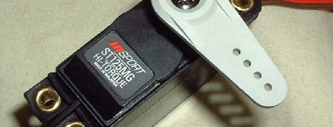

Radio Installation
Graciously provided for this review was the JR Sport Airpac that included five ST125MG 125 oz/in high torque servos, one RS600 6 channel receiver, one switch harness, one 1500mah flight battery, and two servo extensions. Also provided was a ST47BB standard servo for the throttle.
After reviewing these items on Horizon Hobby's website, it seemed that they were a fairly new offering from JR. JR, as I'm sure everyone knows, is one of if not the major player in R/C control systems. When thinking of JR one tends to think high quality. Unfortunately, many times high price also comes to mind when thinking of this brand. Not so with these new equipment offerings. JR contends that while they have drastically cut costs on these items, they haven't cut corners on quality.
After using this equipment I had to agree. The high torque servos were very quick without having to go to a 6v flight battery. They seemed to have the rated 125 oz. of torque, although I had no way of testing that fact. Finally and most importantly in my book, they had nearly zero slop and centered perfectly every time. For a 3D model this was crucial.
The receiver was very compact and light. Light enough in fact that it could have been used in park flyers if so desired. It performed perfectly with no problems detected during range testing and no perceived glitches to date. So cheers to JR for creating reasonably priced equipment that carries on their tradition of high quality!
Radio installation on the SuperStar was a breeze. There was plenty of room throughout the model for whatever equipment one might choose. Since analog servos were provided I added a servo reversing "Y" cable to synchronize the twin elevator servos. If digital servos were used or if a capable computer transmitter was available, this item would not have been needed.
Of special note were the pushrods, linkages, and control horn hardware. All of these items were top quality and quite stiff. An important necessity for a good performing 3D or pattern ship.
Engine Installation
The 1.80 size Saito four stroke was a joy to work with from start to finish. Following the break-in instructions carefully, I erred to the safe side on how long I ran the engine extra rich while keeping the RPM's low. By the time I was ready to fine tune the big Saito, I had run nearly a gallon of glow fuel through it on the test stand. After that I gradually started leaning out the high speed needle while watching the RPM's closely with the tachometer. After a few more tanks I had the 1.80 turning the 16X8 break-in prop nearly 9800 RPM!! This was phenomenal in my opinion. Last year in comparison, I converted a 31cc weed wacker engine to model aircraft use swinging this same prop. The gas engine turned only 8300 RPM and it weighs almost twice as much as the Saito 1.80! The gas engine is flying a 15 lb plane with authority.
At this point I adjusted the valves as recommended by the manual and then bolted on an APC 18-6W 3D prop with which I planned to fly the SuperStar. This completed the break-in procedure and I retuned the engine one last time achieving a tach measurement of 8500 RPM. Still significantly more than the gas engine and with more prop. The engine had no problem idling at 2000 RPM for long periods and roared to life instantly when full throttle was applied. Throttle response was very linear and precise. At this point I knew I had a winner with more than enough power and response for any 3D maneuver.
At first glance, mounting the engine and cowling looked like it would be as quick and easy as the previous steps. However it soon turned out to be the most difficult part of assembling the SuperStar. The manual offers only a few pictures of the process. These pictures combined with some predrilled holes on the fuselage, one measurement from the firewall, and the motor mount were all the clues I had.
I installed the engine the specified distance from the firewall squarely on the motor mount. Next I trial fit the cowl using the landing gear and pictures as a guide. The predrilled holes on the fuselage were quite a bit off and the angle of the cowl in relation to the engine was even worse. After some thought I decided that the most important consideration was that the thrust line of the engine be zero degrees to the wing. I examined the roots of the wings and decided that a straight edge along the fuselage in line with the spar and wing mount holes should establish a zero thrust line.
After lining up the engine with the straight edge, the engine seemed to have several degrees of up thrust in relation to the mount. However the cowl and engine were now nearly at the same angle and the fuselage holes were closer, although still unusable. This was encouraging so I proceeded to drill new holes for the mounting screws and secured the cowling.
The next task was to install the muffler and create holes in the cowling for the exhaust, head access/cooling, fuel filler line, and high speed needle valve. The process was unique for this engine and just required a lot of patient trial and error. I did encounter a little trouble toward the end of the process. The cowl cracked on one side where it was screwed to the lower part of the fuselage. This was understandable as the glass cowl was forced to deform quite a bit as it tightened down.
I removed the cowl one last time and reinforced the four areas where screws held it to the fuselage. A couple of layers of medium glass cloth and some thinned 30 minute epoxy did the job. I Thought the end result was very attractive, very sturdy, and of course functional.

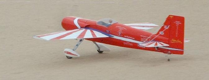

  • Take Off and Landing
    Taking off the SuperStar required no special technique or effort. I simply had to choose between a scale takeoff or the crowd pleaser takeoff. For IMAC purposes, half throttle was the best practice, producing a short takeoff roll. First the tail would rise up leveling the aircraft from it's tail dragger taxiing position. A few seconds later the SuperStar would gently float off the ground and gain altitude without losing it's original position in relationship to the ground.
    Then there was the "CROWD PLEASER" which could be loosely associated with 3D flying. The SuperStar was simply taxied to the end of the runway, lined up into the wind, and then the throttle was firewalled. What followed was a ridiculously short roll followed by climbing vertically. A handlaunched foamy could do no better!
    Landings were another story. I've gotten quite used to greasing landings. And I mean every landing. I can't remember the last time I did the 'ole "Hey, that was four good landings in a row!" after one flight. But the SuperStar simply did not want to stop flying. It was like learning to land all over again. After several touch and goes I came to the conclusion that the SuperStar liked best to stay level and land on the mains with a little extra airspeed. Once the mains were firmly on the ground, airspeed could be bled off until the tail gently settled. Attempts at 3 point landings consistently produced anywhere from two to five bounces.
    Ground handling on takeoff was really not an issue. The tail came off the ground so quick that the super effective rudder was steering the plane 99% of the time. However taxiing back to the pit proved to be quite a chore, until I realized high rate was needed to counter the weathervaning. The first problem I discovered was that even after a decent landing with no bounces, the tail gear would bend. This would render the tail wheel almost completely useless and the SuperStar would be all over the field scraping wing tips and trying to do ground loops. An after market tail gear was purchased and installed which helped quite a bit.
    However there was still some problem getting the SuperStar to stay on track. During a particularly windy day during flight trials the problem became clear. The generous fuselage side area and large rudder were weather-vaning in the wind and overcoming the tail wheel! Once the problem was identified, I simply threw the high rate switch once the SuperStar landed. This increased the tail wheel travel and no further taxiing problems were observed.
