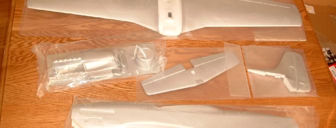

Upon opening the box, I found all foam components of the model to be individually bagged. Unfortunately, the other components, particularly the Frio brushless motor and retracts, were not secured in the box and had caused numerous scratches, dings, and gouges to the foam components.
The included selection of hardware is very complete. All pushrods, control horns, hinges, wheels, Velcro, etc. are in the box. Also included are the vacuum formed cowl and canopy, retractable landing gear and 3 spinners in blue, red, and yellow.

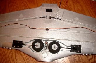

Retracts
One item of concern that I had with the build is that the retracts were very hard to get adjusted properly. While they will lock, I had a very hard time getting the adjustments just right. Unless the retracts are properly set to lock, especially in the down position, the retracts will collapse on landing and it is possible to damage the retract servo.

  • Flap setup was harder than expected.
  • Spinner mount required cutting into the cowl or leaving a gap between cowl and spinner
  • Retracts very hard to get adjusted properly
