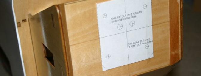

Engine mounting -- Great Planes couldn't have made this any easier!
Engine Spacing Suggestion
This small, light engine is mounted at the end of the mount and this allows the engine to have alot of flexibility which can cause the mount to break. I removed my cowl 2 times at the flying field because I thought the engine bolts came loose as I could grab the spinner and wiggle it around. I would recommend mounting the engine farther back in the mount and spacing the mount itself away from the firewall to get the recommended hub/firewall distance.
This couldn't be any simpler, without them including and installing the engine for me!

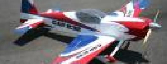

I ran a tank of fuel thru the OS 1.60 engine on the ground to start the break in process. After that the Cap was ready to test fly.
After installing the wing with 2 nylon bolts, I filled up the tank, primed the 1.60, and it fired right up on a single flip of the 18x6 prop. After some adjusting of the low end and a good range check I taxied out to the runway and was cleared for takeoff.
Take-off and Landing
Takeoff was effortless!
The Cap 3D just floats in for landings and is very easy to control. The Cap is a real floater and didn't have any bad tendencies to drop a wing or snap, not to say that it won't if too much elevator is used with not enough airspeed.
Aerobatics
After adjusting the engine some more it was time to have some fun with the cap. I tried some basic aerobatics, which it performed with no problem -- loops, rolls, spins, etc. It will harrier with only minimal wing rocking and no mixing of the ailerons. Waterfalls were great and blenders/inverted spins were very flat. This was turning out to be a great 3d plane!
Rolls were very quick on high rates and knife edge had some coupling to the gear, which is caused or at least exaggerated by my rear CG point. Inverted flight needed no down elevator to fly level so the CG felt perfect to me for 3D flight. Other pilots may want to add a little more lead to the nose than I did if you are not comfortable with flying a plane with it set at the rear limits.
