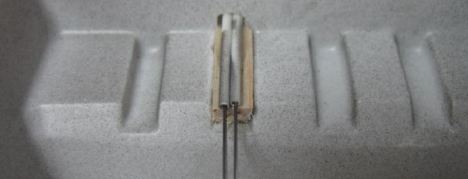

Servo installation is very simple, but a bit unique.
When gluing servos I prefer to first wrap them with fiber stranded tape. After taping, I roughen the outer coating of the tape until the glass fibers start to just fray and then epoxy the servo with a very small amount of glue to the foam sides. Then, if I later need to re-use the servo in the future, the tape has protected the case.
Ailerons are positioned with 1mm of up in both per the instructions. This will help the slow speed stability of the plane by applying slight washout. The wing also appeared to have a small amount of washout molded in, allowing the model to slow well.
In order to accommodate the EZ connector height above the servo arm I trimmed the plastic area where the pushrod tubes enter the rear of the fuselage. This gave me a direct shot to the EZ connector with no binding. Then I used a small scrap of balsa to elevate the tubes so they would attach to the servo with no binding or bending. The tubes must be glued to provide the necessary rigidity for the thin wire pushrods.

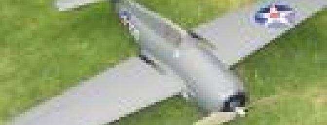

I have long loved the lines of Grumman planes and this Wildcat is certainly no exception. With a plane this pretty you need to snap some pictures before the first flight. It has true scale lines and is a fantastic looking plane!
First flight
The Alfa F4F Wildcat is simply amazing. It lives up to the Alfa reputation of flying right out of your hand. It is totally predictable with smooth turns and maneuvers. I describe few planes as being “flawless” but this Wildcat is as close to that as any small plane that I have ever flown. If it is any indication of how much I like flying this plane, on most reviews I shoot video as quickly as possible just in case the worse case scenario crash occurs. I flew this plane at least dozen times before shooting video because it was so much fun to fly!
The Wildcat required minor elevator trim changes and those had the model flying straight and level. On first flights I make all attempts to check the basics, trim the airplane and check stall characteristics.
