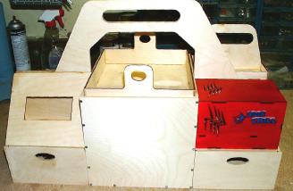

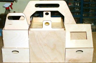

I began by inventorying and inspecting each piece. All the machine cutting was very well done. There were a few rough edges left from the cutting process, but nothing to complain about. I carefully went over each piece with a palm sander with 220 grit sandpaper, smoothing all the edges. I then followed up with 400 grit, to get a nice smooth finish. It was then just a matter of assembling the interlocking pieces following the well detailed, photo illustrated, step by step instructions.
All the pieces aligned and fit very well. The fit was snug in a few of the slots. I found by "very slightly" rounding the edges on the corresponding piece it made assembly much easier. Then just a little touch up with wood filler here and there. I gave it a quick once over with 400 grit sandpaper and it was ready to stain or paint.
The laser cut components:
  • radio tray,
  • tool holder, and
  • "Quik Chill"
These parts all aligned and fit perfectly.
I used carpenter's glue and medium CA throughout the building process.
In a couple evenings of pleasant building. I had the the project finished and ready for the field.
Quik Chill
This was such a neat idea I felt it needed it's own section. The laser cutting and fit was so good it required no sanding, and could be completely assembled with rubber bands prior to gluing. The included 12 volt fan was very quiet and moved a lot of air through the box. It can be loaded from the rear or, by leaving the top unglued, loaded from the top.
The included banana plug kit consisted of two male and two female connectors. I only had to supply my own wiring for the connections.
The "Quik Chill" is also available separately as a stand alone unit. By leaving the tool caddy at home, it's possible to mount a second "Quik Chill" to the ElectroTote!
After I filled any imperfections with wood filler and sanding, a quick once over with a tack rag, and it was ready for finish. I applied a coat of wood stain followed by a couple coats of poly sealer. Lightly sanding between coats. The plywood in the kit was of excellent quality, allowing for any type of finish you might want to apply. Since there was to be no glow fuel involved, any type of spray paint would also have worked very well.
After the individual components were then attached to the box with the included Velcro squares, I wired up the batteries, filled the drawers and tool box with the necessities, and was ready to head to the field!
