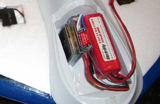

Radio Installation
I found that I needed to open up the wall at the back of the radio hatch so that I could place the ESC and battery further aft to achieve the recommended center of gravity.
