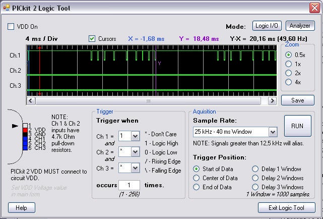

Another possibility of the same hardware is to use it to generate a PPM signal.
So that with a genuine PC Joystick connected to your PC and a small exe running on it, you can output the PPM signal to any RC radio (student plug) and fly your favorite plane with a joystick. (I had been asked to do it by a -real-copter pilot).
The GUI is quite simple :
1) any PC joystick works (tested with Microsoft force feedback joystick and logitech gamepad
2) 8 axes joysticks are recognized
3) the "rotating button" are also recognized
4) 8 buttons as well
5) the PIC board is plug and play (no driver needed as it is a HID device)
6) all inputs are remapable to any PP output channel
7) you can apply trim and reverse the output channels
Finally here is a test with my Hobbyking TH9x radio flashed with ER9x firmware
For the purpose of this demo I have only setup the radio to decommutate 4 PPM channels (but trust me it works with 8 !)
And I have connected 2 servos to see the result "lively"
The sound is in french --> free french training session
Joystck PC to PPM (2 min 17 sec)
JP

I have been studying your code ( good_main.c is the latest, right?) and I understood most of structure. I would like to connect the futaba 7cap Tx trainer signal, so I will add a NPN transistor for input. This will cause the PPM signal will beinverted. However your code checks falling edge, so I think this part of your code will stay same.

Please use "main.c" ... good_main.c was an old version...
The code shouldn't be sensitive to inverted or regular PPM signal. I have already tested it with futaba radio and TH9x radio and it works although they don't have the same PPM polarization
Try to understand why with a simple drawing, it's just a matter of logic (no need to look at the code) ! (but difficult to explain with words ...)
