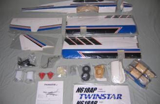

All major parts are individually wrapped and carefully packed in a sturdy box with tantalizing graphics. The Twinstar comes with an excellent 24-page construction manual that includes clear instructions and numerous pictures of the various steps.

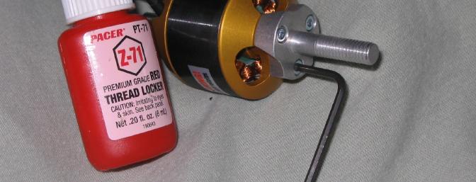

I used Pacer Z71 red thread locking compound to lock the prop adapter screws and mounting plate in place on each motor.

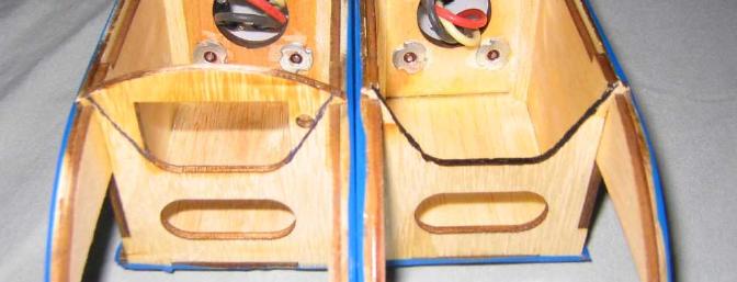

Next I needed to cut some spacers to position the motors far enough forward in the nacelles to insure adequate prop clearance. For the APC 9x6E props, I needed 1-3/4 inch spacers. I like to use 1-1/2 inch diameter plastic drainpipe for the motor spacers. An ACE Hardware 12 inch Tailpiece is light in weight, not too brittle, and the proper outside diameter for the AXI Motor mount. I made two spacers 1-3/4 inch long and drilled a 3/8 inch hole in the middle of each piece for the motor wires. Now I could mount each motor using four 2-1/4 inch 6/32 bolts.
Next I cut away a portion of the rear former of each nacelle. This area was needed for battery mounting and for cooling airflow.

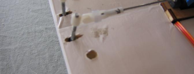

Using the nacelles as a pattern, I marked each wing shear web for a matching oval hole. I then cut a hole in each of the two wing shear webs on each wing. These holes were needed for additional airflow to cool the ESC’s and batteries. Next I coated the inside of the shear webs and the back of the rearmost shear web with slow curing (30 minute) epoxy. This would restore the web strength lost due to the cooling holes. The front surface of the front shear web would be coated with epoxy in a later step when I installed the nacelles.

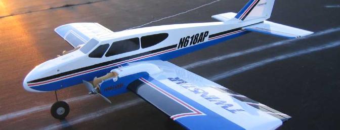

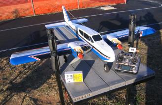

Pre-Flight static testing of the motor/ESC/battery combinations showed 300 watts of power per motor turning the APC 9x6E props at an amazing 11,120 rpm. That translated into a 1:1 thrust ratio at about 2/3 throttle! With 112 watts of power per pound, this was going to be fun!
Initial taxi tests showed that the differential thrust was very effective in helping turn the plane without the tipping over normally associated with sensitive nose gear steering. The weather finally cooperated and we were able to roll out the Twinstar for its maiden flight. All of the Club “Pros” gave their somewhat negative opinions about electric power before the flight. The tone of their comments changed dramatically when I advanced the throttle to 2/3, pointed the Twinstar straight up and briefly released the fuselage and the plane just hovered in space.
For the first flight I set all the rates to low and switched the differential thrust to the “off” position. The first flight takeoff occurred quickly and included a 2/3-throttle climb out at about 80 degrees. The Twinstar was rock solid and just wanted to keep climbing.
Two clicks of down trim and two clicks of left aileron trim produced straight and level flight. I went through my usual 1st flight routine of testing control authority, stall characteristics, and some mild manuevers. Before I knew it, my flight timer said it was time to land (6 Minutes), but the Twinstar was begging to keep flying. I reluctantly set up a landing pattern and the Twinstar settled in smooth as silk. It must be the Twinstar, because my landings are not usually that smooth. Post-flight inspection showed the AXI motors cool to the touch and the TP batteries and JETI ESC’s barely warm. There was nothing but positive comments up and down the flight line after that first flight. It wasn’t until later in the morning that I realized how relaxed I had been during the first flight. I'm sure that not having to worry about engine outs, like on the glow twins I had flown previously, made a big difference. I was able to fly lower, more aggressively, and with greater confidence because of the reliability of the electric power system on this Twinstar. AXI brushless motors, JETI ESC's and Thunder Power LiPoly's are truly the power source of choice for Hobbico's excellent Twinstar ARF.

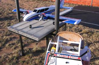

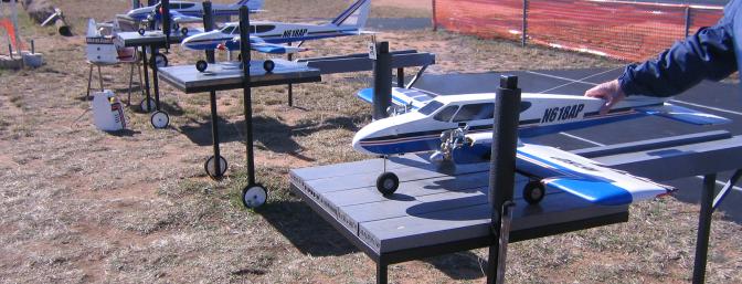

With the help of a fellow club member I was able to fly and compare three versions of the Twinstar in one morning. It was my personal version of a “Triple Double”. Twinstar #2 was an older version of the ARF powered by OS .40 LA engines. It weighed 7 lbs 4 oz. Ready-to-fly (RTF). Twinstar #3 was a recent version powered by Thunder Tiger .25 engines. It weighed an even 6 lbs RTF.
The .40 powered Twinstar flew “heavy”. Even though it had more power than its counterparts, it had to fly faster to keep it’s extra weight airborne. Maneuvers were not nearly as crisp and the plane took a lot more sky to turn around and get back in the pattern. It also took a lot more elevator to flare on landings. Five minutes was maximum flight time due to those little fuel tanks in the nacelles. Even though it may not have flown as good as the other two Twinstars, it flew better than most other twins I have flown.
The .25 powered Twinstar flew almost identically to the e-powered version. It was not quite as fast at top speed as the e-twin, but the .25 glow version flew great. At 2/3 throttle setting, the .25 Twinstar flew maneuvers with ease and there was no problem keeping it in the pattern. Landings were a thing of beauty. Six minutes was maximum .25 glow powered flight time. Glow power or E-Power, Hobbico really has a winner with this ARF!
