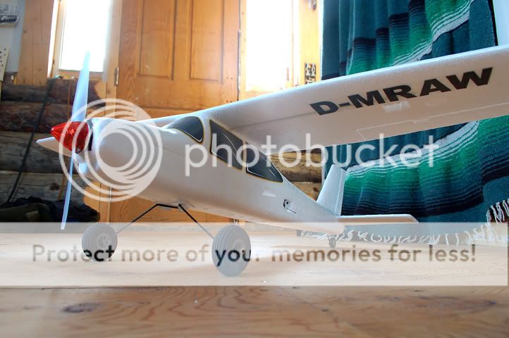

Here are a couple photo's of my 2nd minimag; my first one got lost in a thermal a couple years ago while doing some high altitude photography...... This one has about 4 hours on it now, mostly at -15 to -20 celcius. (I am patiently waiting for spring!) Its got 2 1/4" tires, tail wheel, HS65HB servos, 30A sc, a 1450 Kv brushless and a 8x4 GWS prop. It flies very well like this, its ready to fly weight with a 2200 Mah 3 cell Lipo is 649 grams. I am now waiting for 2 1/2" tires, a 1050 Kv motor, a couple more servos and a y-harness. I plan to try an 8x6 or 9x5 prop with this motor, and am also planning to paint or cover this plane..... (got floats coming as well!)
[IMG][/IMG]
[IMG][/IMG]

I like it in white...pretty cool. Love my minimag...one tough bird.
