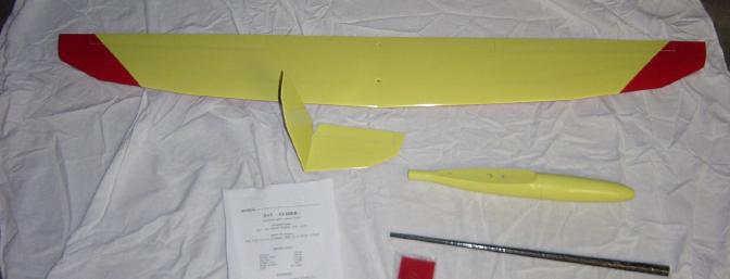

How many times have you trekked up to your local slope, only to be greeted by wisps of wind and return home after a day of 0 stick time? I know I sure have more times than I would like to remember....The Bat from Soaring USA was the answer to my prayers. It is a super light air sloper for those weak days at the slope, or even for some HLG at the local field or park.
The assembly of this model was fairly straight forward, as are most molded planes. There were very few things that actually needed to be built, most steps were radio installation. This was a mixed blessing. Yes, it made it easier to get the plane flying, but to a novice or inexperienced builder, the lack of instructions can it an unnecessarily tricky plane to build.
IMPORTANT Make sure you get the servo(s) centered before installing them in the wing.
Once the servo well was open, I had to route all the wiring through the wing, which was really easy for two reasons: the wing was hollow, and there was a pre-made hole cut in the wing that aligned to the pre-cut hole in the fuselage. This was a huge plus in prefabrication.
The following step was to make some control horns for the ailerons. In most cases the distributor will supply these, but not for this plane, so I ended up making my own. These were made from a hard plastic that I found lying around the house, similar to a Compact Disk, only a little stiffer. It was important to get the holes on each horn lined up for both sides to insure equal deflection but as long as they were close it was not a big deal. These were made from a similar template I cut out and then sanded to size.

The center of gravity on gliders is a very funny thing, everyone has their own personal preferences so you don't have to stick to what I am flying. The sheet that came with the plane did not indicate where to have the CG, which made getting it close a real challenge. The way most designs are laid out, I like to start with the center of gravity just behind the back of the main spar....Which came out to be around 2-11/16 inches behind the L.E of the wing. I knew it would fly, but I wasn't too sure that this was the final location. After some flight tests(dive and inverted) I found that I was VERY close. At the end of the day I re-measured and found that I had moved it to 2 9/16 inches behind the leading edge. With the lead needed for balance, I ended out with a total weight of 16.9 oz., which was awesome for a light air sloper. Let's go fly!!
