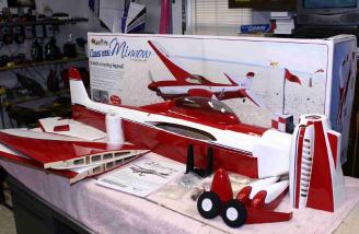

FIRST GLANCE
The kit box arrived at the workshop and I immediately dove into its depths looking for any shipping problems or defects. All major parts were packaged in plastic bags, and I could not find any damage other than the typical ARF wrinkles in a few of the parts covered with Monokote.
The sleek, slim fiberglass fuselage was painted to match the cowl and the Monokote covering on the wing and tail. Well, it almost matched the other parts. The red on the cowl was darker than the red on the fuselage. The red on the rear of the canopy was lighter than the red on the front of the canopy. Maybe it didn’t come from the same spray can. It was a close match, but far from being perfect. I also noticed some very slight high spots on the fuselage that matched the interior former locations. You have to really look for them, but they are there.
I have started to weigh everything that comes in an ARF kit box to determine if the suggested weight of the completed model could be met. In the case of the Minnow, the total parts weight was 6.15 pounds, and by adding the weight of the engine, servos, receiver and battery, I predict that the total weight of the Minnow will be 8.4 pounds, just a slight bit more than the high end of the advertised weight range.
