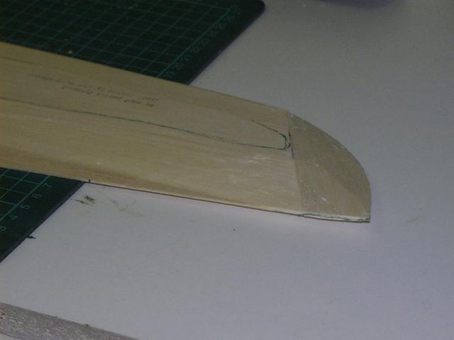

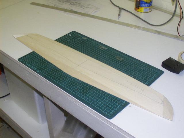

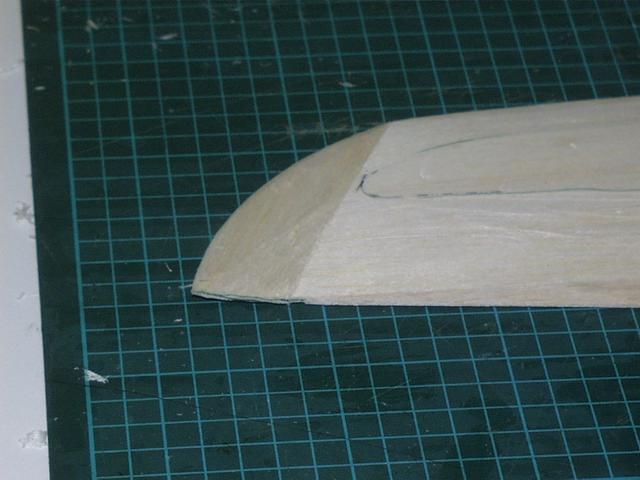

Uh oh... I was trying to build the wing, and while trying to join 2 sheets of 1/4" balsa, I met problems - they don't meet perfectly!!! I think they need some sanding.
Paul, care to explain what the oval-shaped dotted line on the wing means?

csisfun,
That is the outline of where you must plane off the balsa (to the centerline of the LE).
See the following pictures --- you can see how I've shaved off the wood from around that 'dotted line'. Note that I took the wood down to the bottom of the plank for the trailing edge, and the -middle- of the plank for the leading edge.

Does that mean that whatever is inside the oval should not be touched? I don't quite understand.

On the initial shave-down process, no, don't shave anything out of the inner area. However after you have shaved off the wood you can then sand down everything to a nice smooth profile, this will require you to sand off wood from the inner oval area. You'll notice on the latest plans there's a dotted line which also indicates the "peak" of the airfoil. With planes line this it's really more of a TLAR thing (That looks about right). Get it smooth and 'flowing' and you'll be right.
