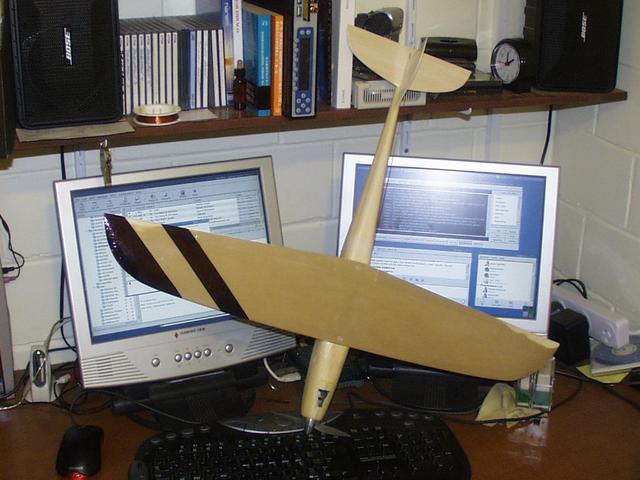

Looking much like the previous one, here's a picture of the rebuild process. You'll notice I've used the same wing, since it was perfect, not a scratch (from the accident).

Well it's all done - Slipso #3 taxies out to the runway for its maiden in about 8 hours time.
Here's a few pictures of it -before- heading for the big sky.
